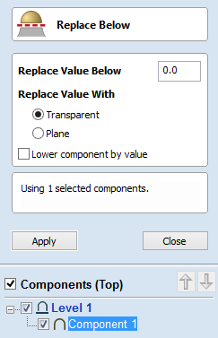

This feature allows you to trim (or flatten) the bottom off a component or multiple components. This could be useful if you've imported an STL model that has some undesired thickness, for example, when it has come from a 3D scan. Also, sometimes you could end up with an undesired negative part of the components (when sculpting, or combining with a deep subtracted model). This tool will allow you to remove anything below a certain height, and (optionally) drop the model by that height.

Options & Parameters
Replace Value Below
Replace areas that are below the given height with the height chosen by Replace Value With.
Replace Value With
This will control what value to replace those areas with.
  • Transparent: Completely remove those areas, and replace them with transparency.
  • Plane: Replaces those areas with a plane. The height of the plane is the height input above.
Lower Component by Value
When this option is checked, the model will be dropped by the given height. This is useful if the model is too thick and/or we want to get rid of some background (i.e. one that has come in with an STL model). If you set this to 0, it will remove everything below the Zero-Plane.
