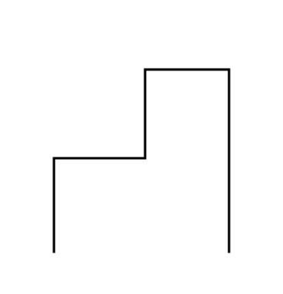

When using a custom profile, the form the final shape will take comes from considering the shape above the line joining the end points. For this reason the profile vector should usually have a leg.

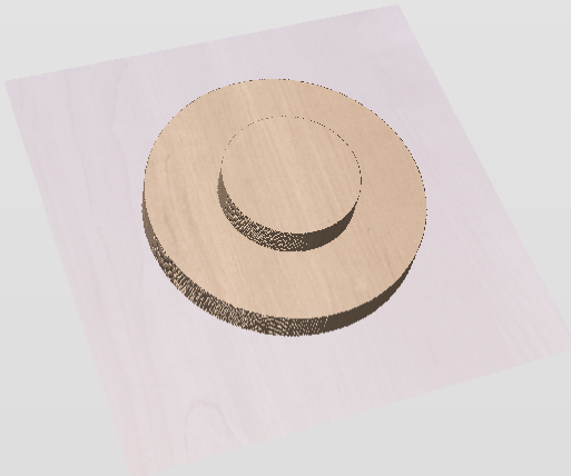

Profile with leg
Result of profile with leg

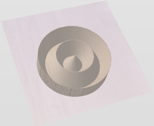

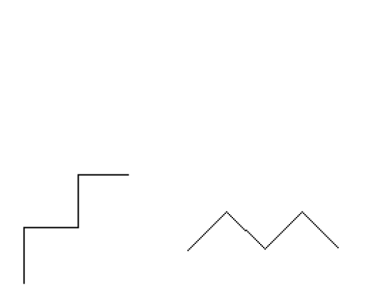

Profile without leg (left) and how this profile is interpreted by the software (right)
Result of profile without leg

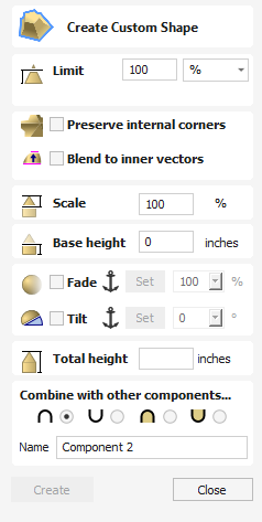

Limit
This will limit the height of the shape created. This can be entered in as a value or you can use the slider bar in the drop down menu.
