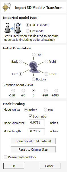

Importing a 3D Model into Rotary job
Imported model type
Allows the nature of the imported model to be specified. Depending on the selection, the form will change to allow the most appropriate workflow. You can choose from the following model types:
  • Full 3D model - a model that is suitable for rotary machining as is,
  • Flat model - a model that is only suitable as a part of design, similar to clipart provided with Aspire.
Initial Orientation
The purpose of this section is to roughly position the imported model within the material block. One can choose one of the 6 options to determine the most suitable direction on the model that defines the top surface (upper Z). This can be combined with one of the five options for Rotation about Z Axis.
The software will try to guess the initial orientation that seems to be appropriate for the model, based on the model type selected in step one.

Rotation Axis Movement (Full 3D model only)
This section can be used to adjust the position of the model in relation to the rotation centerline. By default Aspire will position the model in the center of the material block, so the material is used more efficiently.
When the Off option is selected, panning the 3D View will happen in the usual manner.
When the On option becomes selected, using the 3D View panning controls will move the rotation axis instead.
Model Scaling (Full 3D model)
This section allows the model scale to be adjusted as desired. The model bounding cylinder (blue) will be displayed around the imported model in the 3D View. The scaling is performed by means of length and diameter of the bounding cylinder. When the model orientation within the material block changes, so does the bounding cylinder. If that happens, the reported size of the model will change, although the model may not have been scaled.
Model units
By default Aspire assumes that the imported model is using the same units as specified during job setup. If that is not the case, the model units can be changed.
If the model units are different than those selected during job setup, the imported model will be converted to use the units selected during job setup.
Lock ratio
When this option is selected, all scaling operations will maintain the current ratio between model length and diameter.
Scale model to fit material
This option can be used to resize the imported model so it will fit in the material block as defined during job setup.
Reset to Original Size
This option undoes any scaling applied to the model (apart from unit conversion), regardless of the model orientation.
Resize material block
When this option is selected, the project's material block will be resized to match the final dimensions of the imported model.

OK
Creates a 3D Component based on the settings in the form, the Component will have the same name as the imported file.
