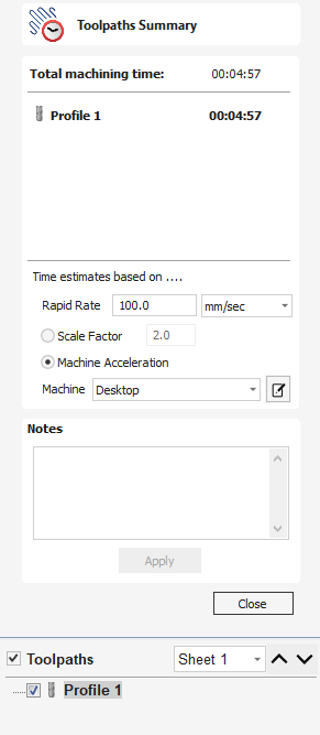

Estimating Machining Times
This option estimates the machining times for all calculated toolpaths based on the feed rates specified for each tool. The estimates for individual toolpaths plus the overall machining time of all visible toolpaths are calculated using the user defined Rapid Rate moves and Scale Factor, the Machine Acceleration calculations.
Rapid Rate
The maximum feed rate at which the machine runs for rapid moves, typically specified using a G0 or G00 move
Scale Factor
The nature of different styles of toolpaths means that they may be simple 2D cuts or require simultaneous 3-axis moves, the more complex the toolpath then the more chance the CNC machine may not actually achieve the programmed feed rates. This can be compensated for by multiplying the times by the Scale Factor.
The scale factor in the program lets you approximate this slowdown for your machine, but it will vary depending on the type of work you are doing. Many people will use one scale factor for simple 2D work and another for 3D or VCarving. The best way to calculate it is just to take a note of estimated and actual machining times of a period of time.
For machines where the controller provides an estimated machining time, these should be more accurate as the controller can determine where the machine is accelerating / decelerating and take account of this.
Using the Machine Acceleration values will allow you to get a more accurate time estimation.
This will calculate the speed the machine will be able achieve up to the feedrate of the toolpath, based on the acceleration settings given.
For accurate Acceleration values of your machine, contact your machine supplier.
Machine
Select the machine you with to use the Acceleration values from the dropdown menu.
Machine Configuration
If you need to adjust the Acceletation options for a machine, you can use the link to the Machine configuration tool
