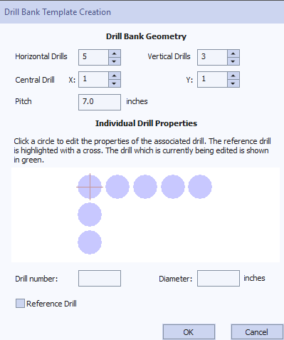

Configuring a Drill Bank
The Drill Bank Template Creation tool allows you to define a reusable drilling pattern (a drill bank) that can be applied consistently across cabinet parts. This is typically used for operations such as shelf pin holes, dowel holes, or construction drilling that must follow a precise and repeatable layout.

Horizontal Drills
Specifies the number of drill holes arranged horizontally.
Vertical Drills
Specifies the number of drill holes arranged vertically.
Central Drill (X, Y)
Defines which drill in the grid is considered the central reference drill.
  • X represents the horizontal index
  • Y represents the vertical index
This reference drill is used as the origin point when positioning the drill bank relative to a part.
Pitch
Defines the spacing between adjacent drill holes.
All holes are evenly spaced using this value. Units are shown alongside the field (for example, inches).
Drill Selection
  • Click on any drill marker in the preview to edit its properties
  • The currently edited drill is shown highlighted
  • The reference drill is marked with a cross
This makes it easy to visually identify both the active drill and the reference point of the pattern.
Drill Number
Specifies the tool number used for this drill. This corresponds to the drill definition used by the machining system.
To support machines that number the horizontal and vertical drill arrays independently, the drill that is common to both can be assigned a number for each.
Diameter
Specifies the diameter of the selected drill hole. The unit is shown next to the input field. The display will update to give a visual overview.
Reference Drill
Marks the selected drill as the reference drill for the bank.
Only one drill can be the reference drill at any time.
Drill Preview
The graphical preview displays the full drill bank layout based on the current settings. Changes to geometry, pitch, or individual drill properties are reflected immediately, allowing you to visually confirm the pattern before saving.
Pitch Tolerance
The tolerance used for the pitch when looking for matching drill patterns.
Diameter Tolerance
The tolerance used for the diameter when looking for matching drill patterns.
