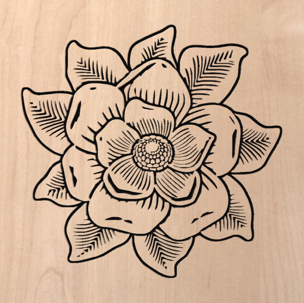

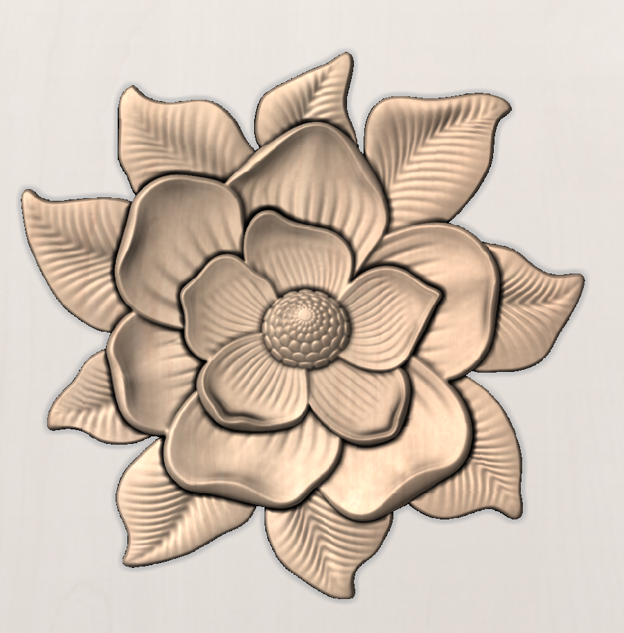

Sketch Carving
This tool uses the differences in contrast between areas of a Bitmap image or a 3D model to create a toolpath and create a Sketching style carving design of the outline.
Original 3D model
Sketch Carve Result

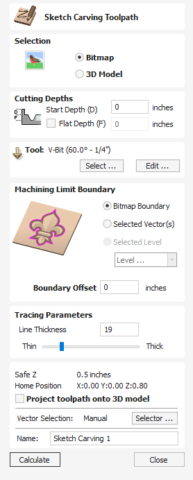

Selection
This allows the User to indicate if the selecting image is either:
Bitmap
An image file imported in the following format .BMP, .JPG, .GIF, .TIF, .TIFF, .PNG, .JPEG
3D Model
A 3D file imported in the following format .STL, .V3M, .3DM, .SKP, .RLF, .3DS, .ASC, .PRJ, .X, .DXF, .LWO, .WRL, .OBJ
Cutting Depths
Start Depth (D)
Start Depth (D) specifies the depth at which the Sketch Carving toolpath is calculated, allowing Sketch Carving to be machined inside a pocket region.
When cutting directly into the surface of a job the Start Depth will usually be 0.0. If the Sketch Carving is going to be machined into the bottom of a pocket or stepped region, the depth of the pocket / step must be entered. For example, to carve or engrave into the bottom of a 0.5 inch deep pocket, the Start Depth = 0.5 inches
Note:
The line thickness will also determine the total cut depth when no flat depth is specified. The resulting carve will be as deep as the tool geometry will allow when the cutting edge of the tool meets the internal and external boundary. This will be achieved within increments of the tool pass depth.

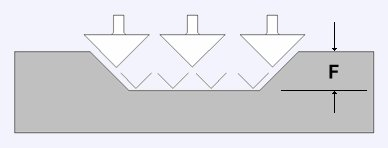

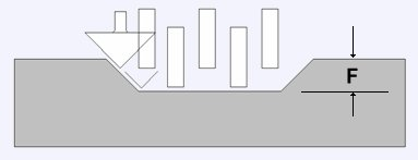

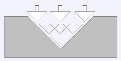

Flat Depth (F)
Checking ✓ this option limits the depth that the tool(s) will machine to, and is used for Flat Bottomed Carving and Engraving.
When No Flat Depth is specified the toolpath will be calculated to carve or engrave to full depth as shown below. Multiple z level passes will be automatically calculated where the tool needs to cut deeper than its Pass Depth specified in the Tool Database
No Flat Depth
Flat Depth
Flat Depth Using 2 Tools
Tool
Clicking the Select button opens the Tool Database from which the required Sketch Carving Tool can be selected. See the section on the Tool Database for more information on this.
Clicking the Edit button opens the Edit Tool form which allows the cutting parameters for the selected tool to be modified, without changing the master information in the database.
Sketch carving is designed to use radiused ball nose, tapered ball nose and angled VBit and Engraving tools. Only these will be selectable in the Tool selection
Machine Limit Boundary
Choose what to use as the outer boundary for the Sketch Carving toolpath
Bitmap/Model Boundary
Using the external edge of the bitmap or 3D file as the boundary for the tools operation.
Selected Vector
Allows a vector to be used as a boundary to limit the extent of the toolpath creation.
Hold SHIFT and select the desired Vector to use as the boundary after selecting the Bitmap or 3D model you are Sketch Carving.
Selected Level
Allows a Component Level to be selected to use the components on that level for a boundary to limit the extent of the toolpath creation.
Boundary Offset
Increase the Machining limit outside of the boundary selected above but the distance used here. The Default value is 0.
