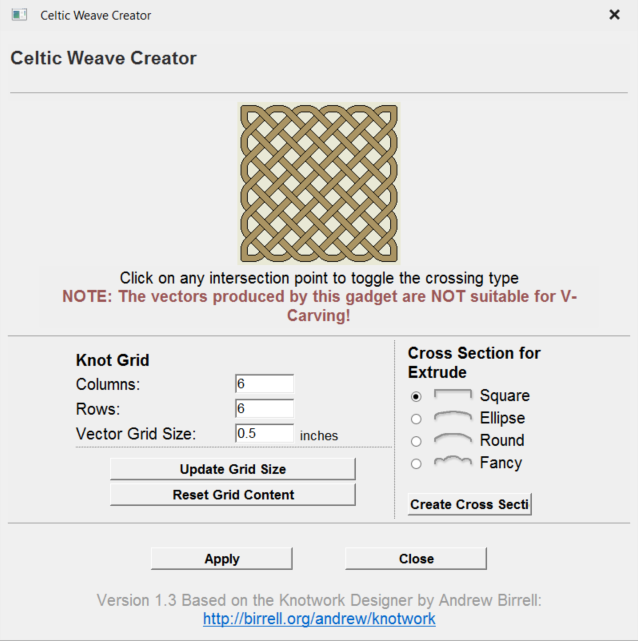

Simply define the size of the weave grid you require. Click Update Grid Size to see your changes reflected in the Weave Preview Image.
Weave Preview Image
Click on the interactive weave image to cycle through the different crossing options at each intersection point. The 3 options are:
  • Cut Vertical
  • Cut Horizontal
  • Cut Neither
You can reset the Weave Preview Image at any time using the Reset Grid Content button.
Cross Sections for Extrude
When you are happy with the layout of the weave pattern, choose which cross-section you would like and clickCreate cross-section to add it to your 2D View.
Click the Apply button to convert the weave design you have created into vectors artwork in the 2D View. You can change the Weave Preview Image and click Apply to update this artwork as often as you like.
Click Close once you are happy with your design. The Celtic Weave Creator form will close, but if you re-select the unedited weave pattern in the 2D View and re-open the Celtic Weave Creator gadget it will reflect you currently selected weave in the Weave Preview Image for further editing.
