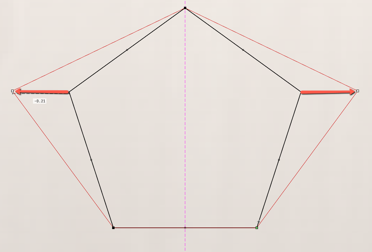

Mirror mode
Within the right click context menu, there are also two options: Mirror Horizontal / Vertical. With these checked you will see a dashed magenta mirror line appear, dividing the shape in the selected direction:
In normal operation when two or more nodes on opposite sides of a shape
are selected together whilst holding Shift ; dragging one point will lead
to all selected points being moved in the same direction. With mirror mode
selected the opposing nodes will move in the opposite direction away from each other. This will only be in the direction selected, so in Horizontal it would be in X and in Vertical in Y.
