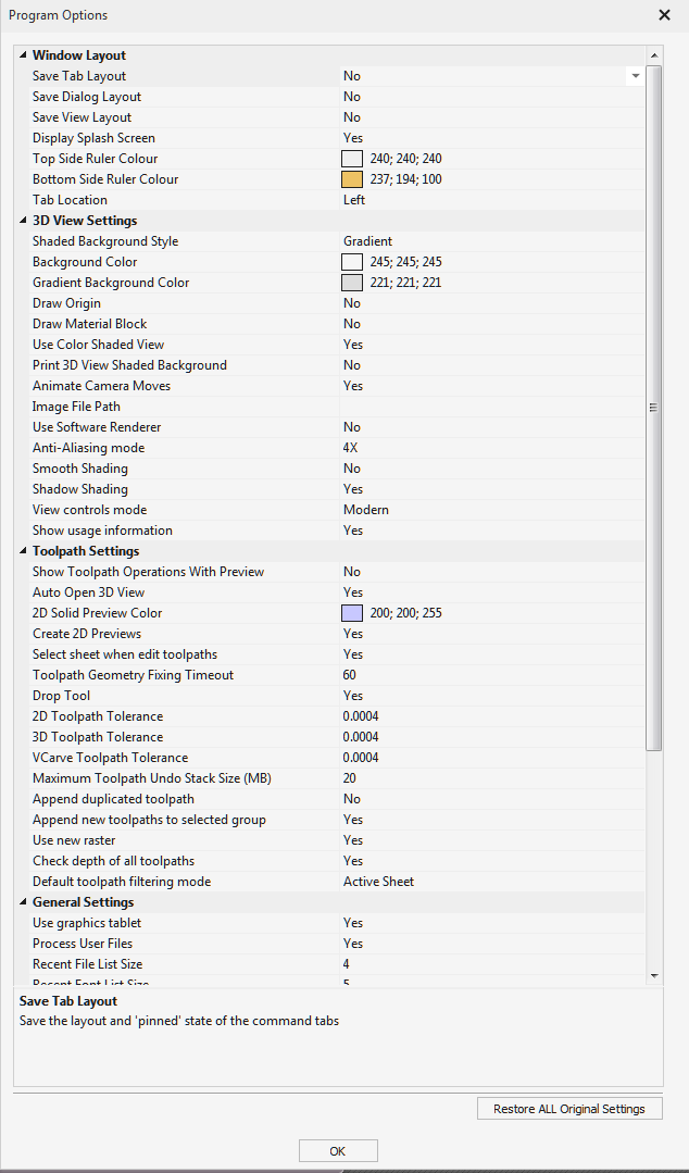

Options Dialog
Many of the choices in this dialog will not take effect until the software has been exited and restarted.
Window Layout
Save Tab Layout
Save the layout and the 'pinned' state of the command and toolpath fly out tabs.
Save Dialog Layout
Save the size, position and visibility for dialogs such as the Layer control and Toolpath Control dialogs.
Save View Layout
Save the layout of the 2D and 3D view windows.
Display Splash Screen
Display the program Splash Screen, while the program is loading.
Top Side Ruler Color
The colour of the ruler on the top side in a two-sided project.
Bottom Side Ruler Color
The colour of the ruler on the bottom side in a two-sided project.
Tab location
Determines where handles for switching between tabs are located
3D View Settings
Shaded Background Style
Allows to choose between Solid, Gradient and Image background styles.
Background Color
Change the background color used for the 3D view. Used with Solid and Gradient background styles.
Gradient Background Color
Change the bottom (lightest) color used for the 3D view. Used with Gradient background style.
Draw Origin
Draw the origin arrows by default on startup.
Draw Material Block
Draws Material Block boundaries by default on startup.
Use Color Shaded View
Draw shaded model in 3D view by default on startup.
Print 3D View Shaded Background
Include the shaded background when printing.
Animate Camera Moves
Switch on/off animation in the 3D View when selecting View positon from the Iso View, Down X, Down Y or Down Z icons.
Image File Path
Path to the image to be used as background. Used with Image background style.
Use Software Renderer
If ‘Yes’ this option switches from hardware GPU rendering to Software rendering which instead utilises the CPU. Software rendering can be preferable in cases where there is limited GPU capability or there are compatibility issues. This will require a software restart for any changes to take effect.
Anti - Aliasing mode
Anti-aliasing can improve the graphic resolution by preventing the distortions and artefacts within the rendering caused by two or more points becoming indistinguishable from one another. There are four different options for the level of anti aliasing you would like to apply; None, 2X,4X and 6X depending on the level required.
Smooth Shading
Select ‘Yes’ to enable smooth shading in the rendering of components which will give them a smoother less faceted (many individual sides) appearance. Turning this feature on will utilize more graphics memory than when disabled.
Shadow Shading
Turns on Shadow Shading by Default if turned on.
View Controls Mode
This gives you the option to use the Modern Mode or Legacy Mode for the 3D view controls.
Modern Model use the right mouse button to move the 3D view.
In Legacy Mode you retain the ability to move the 3D View using the left mouse button.
Please note that if the Legacy 3D view control is selected that some features in the 3D view will not be available.
Show Usage Information
When this option is enabled it will show a description of how to use the current tool at the bottom of the viewer.
Toolpath Settings
Show Toolpath Operations with Preview
When the toolpath Preview form is visible, keep the 'Toolpath Operations' section visible (requires more screen space).
Auto Open 3D view
Automatically swap to 3D view after calculating a toolpath.
2D Solid Preview Color
Color used to draw the solid 2D toolpath preview with.
Create 2D Previews
Create 2D previews of toolpaths in 2D view.
Select Sheet When Edit Toolpaths
If a toolpath is associated with a sheet, select sheet when edit toolpath.
Toolpath Geometry Fixing Timeout
Number of seconds the program will spend trying to fix problems with geometry when calculating toolpaths.
Drop Tool
When projecting a toolpath onto the model, drop the tool on surface rather than project. If this is set, the toolpath will follow the surface of the model better, but could be slower to calculate.
2D Toolpath Tolerance
Tolerance to apply to 2D toolpaths after calculating to reduce file size.
3D Toolpath Tolerance
Tolerance to apply to 3D toolpaths after calculating to reduce file size.
VCarve Toolpath Tolerance
Tolerance to apply to VCarve toolpaths after calculating to reduce file size.
We strongly recommend that the Toolpath Tolerance should be left at their default settings unless different values are recommended by your machine tool manufacturer. If you do have a machine which struggles with the default settings, try doubling the values and cutting a test-piece to assess the tradeoff between machining times, file size and final machined quality. We have done some limited testing and on a sample complex 3D model, increasing the '3D Toolpath Tolerance' to 0.001 inches gave a 40% decrease in file size and no noticeable difference in quality on the test machine and job. In the test case there was no measurable difference in machining time on the CNC machine the test was carried out on.
Maximum Toolpath Undo Stack Size (MB)
Maximum size in MB of Toolpath data undo stack for storing toolpath delete state.
Append duplicated toolpath
When duplicating a toolpath, this determines whether it places the new toolpath next to the original or append it to the end of the list.
Append new toolpaths to selected group
If a toolpath group is selected, add newly created toolpaths to the end of the selected group rather than to the end of the list.
Use new raster
Generate raster toolpaths that are more consistent in regards to machining direction, even for complex shapes.
Check depth of all toolpaths
If this is set to Yes then when job size changes are made then all toolpath depths are checked. If it is set to No then only the toolpaths which are visible have their depth checked
Default toolpath filtering mode
Allows you to choose the toolpath filtering mode used when new file is created or opened.
General Settings
Use Graphics tablet
Switch on support for graphics tablet drivers, if installed - for use with the sculpting tool.
Process User Files
Enable/disable processing of files in the 'Vectric Files' folder in your common user document folder.
Recent File List Size
This sets the maximum number of items that will be displayed in the Recently opened files... list in left hand side bar of the interface when there is no file currently loaded. The list will not increase in size until the software has been re-started and more files have been opened and/or saved.
Recent Font List Size
Sets the maximum number of recently used fonts that will be listed at the top of the font selection box.
Show additional file operations
If set to Yes then this will show an additional row of icons in the Design tab along the top for File New, File Save, Undo and Redo.
Show the clipart Subfolder Contents
If set to Yes then this will show the contents within the selected Folder in the Clip Art browser along with up to 3 sub-folders if they exist and contain appropriate file types. If set to No it will only display the contents of the selected folder, not sub-folders.
Always open local documentation
Force open the local copy of the documentation when accessed through the Help menu. Aspire automatically opens the local documentation if you have no internet connection or if the server is taking too long to respond.
Smooth Join Vectors
Produce a smoother join between 2 vectors. This is option is there mainly to support older behavior.
Default to last used text anchor position
Control the default location of the anchor when creating a text object. This is to either default it to the last set location, or always default to a specific location.
File Dialog Default
This option controls the default directory that is opened when opening or saving files. The default Global options will open the last used folder as per the Operating Systems default behavior. If you choose Operation, the software will remember the last used folder for that particular operation. We divide operations in broad categories, such as, vector import / export, model import / export, toolpaths, tools, etc... If you choose Job, we will always default to your saved job's location.
Confirmation Choices
Sheet Toolpath Deletion Check
When a sheet is deleted, you can choose whether the associated toolpaths will also be deleted.
Toolpath Vector Intersections Check
If vector intersections are detected calculating a V-Carve or Pocket toolpath you can choose to be asked what to do next or to open the Vector Validator. Alternatively, you may forgo the intersections check entirely.
Radiused Offset Intersections Check
If vector intersections are detected when performing a radiused offset you can choose to be asked what to do next or to open the Vector Validator. Alternatively, you may forgo the intersections check entirely.
Sharp Offset Intersections Check
If vector intersections are detected when performing a sharp offset you can choose to be asked what to do next, to open the Vector Validator or to proceed with the offset anyway.
Warn about unsuitable components for embossing
When attempting an embossing operation on a low relief component, display warning to indicate that this model may not be suitable.
Ask which version of the tool database to download
When downloading a tool database from your portal, display a dialog to allow you to specify a database associated with a different product.
Otherwise always download the database associated with the current product.
