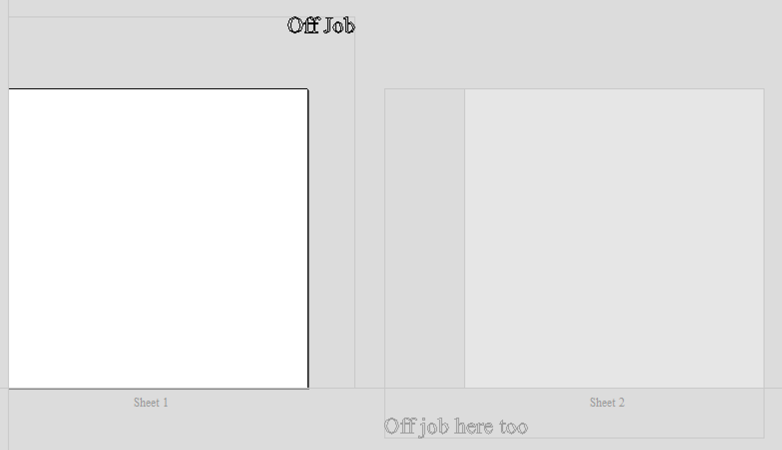

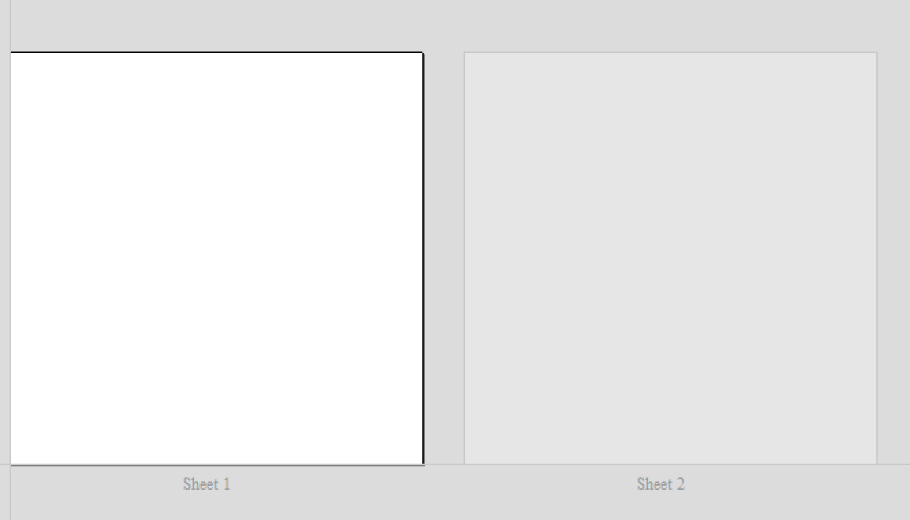

When there are multiple sheets in the job then the outline of the sheets is shown in the 2D view.
Here you can see Sheet 1 Is the Active Sheet.
When vectors lie outside of the bounds of a sheet, then the bounds in the 2D view are updated to indicate this.
A sheet can be activated by using the Sheet Management Tab, using the Sheets Dropdown menu, or by double clicking on the sheet in the 2D view.
