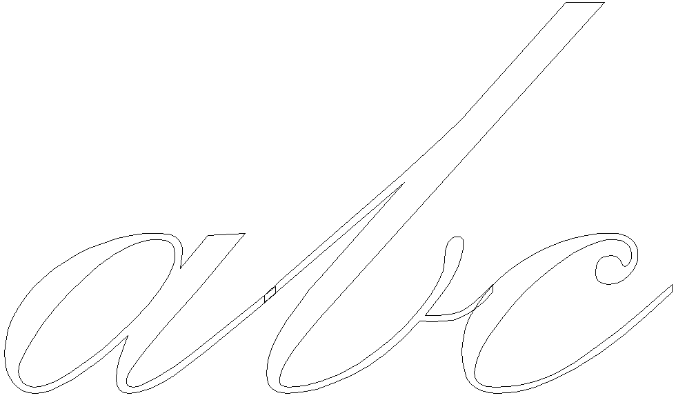

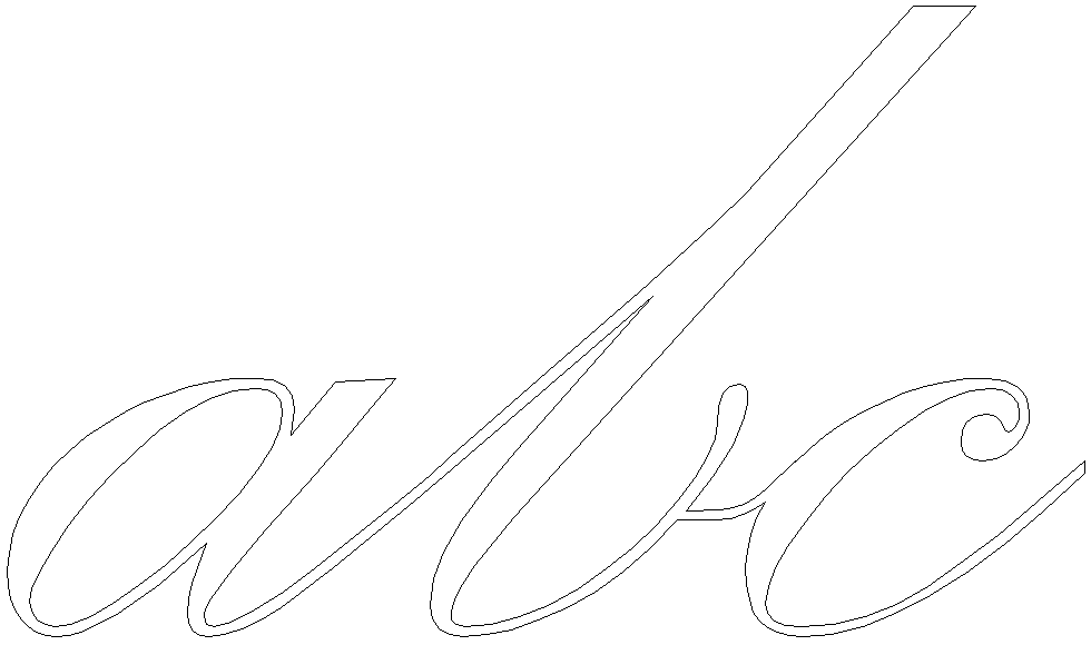

Welds overlapping vectors together to create a new shape which follows the outermost edge of all the selected shapes.
When welding text, the internal regions of characters are preserved.
