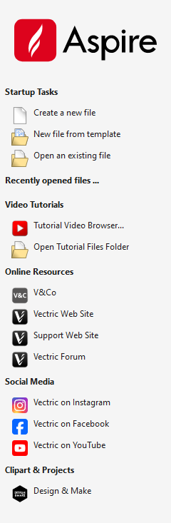

When you first start the program you will see the Startup Task options on the left hand tab and also a list of your 4 most recently opened Aspire parts (this is a rolling list that will be populated each time you run the software and may initially be empty).
Startup Tasks and Recently Opened Files
When you first start the program you will see the Startup Task options on the left hand tab and also a list of your most recently opened Aspire parts.
In the Startup Tasks section you will have the option to Create a new file, New file from template or Open an existing file.
Creating a new file allows you to specify a size and location for a blank work area, set your material thickness and also set the model quality and even the shading color/material. The process to do this will be covered in the next section (Job Setup Form Options).
New file from template will allow you to start a project using a pre-created template file from your computer. The CRVT3D or CRVT template files will have the necessary information for material size etc. already embedded in it. It may also contain vectors and toolpaths that have been created for this template file. Template file are created for settings you use regularly so you do not need to create them each time.
Open an Existing File, will allow you to open a pre-created file from your computer. This may be a file you previously created (*.crv3d or .crv). Alternatively, it might be a 2D vector layout from another CAD system (.dxf, *.eps, *.ai and *.pdf). A CRV3D or CRV file will have the necessary information for material size etc. already embedded in it. The 2D formats will import the data at the size and position it was created but will require you to go through the Job Setup form to verify/edit all the parameters for the part.
