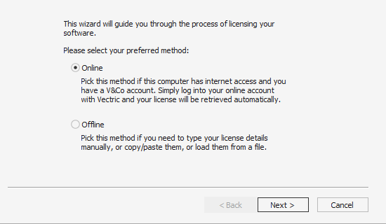

Online Method
This method will allow you to retrieve your details automatically from your V&Co account. To use this select 'Online' and then click Next > on the form. The online section of the form will then be displayed.

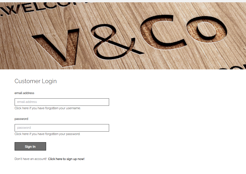

Pressing Login... on this dialog will launch a web browser which will take you to the V&Co login page if authentication is required.

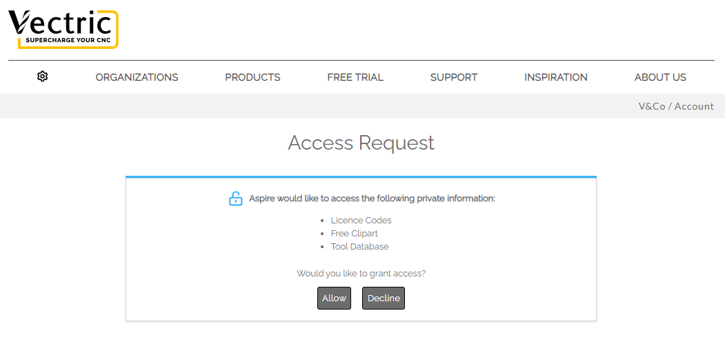

After logging in here with your V&Co account details another page may appear asking for permission for Aspire to access your license details.
This page will only appear if you have not already granted access. If this appears you should select "Allow" to enable Aspire to retrieve your license details automatically.

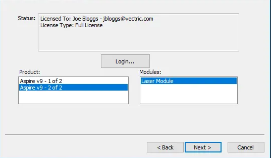

At this point Aspire should be being displayed and the dialog should be automatically populated with any licenses available on your account.
You can select any of the product licenses available and information on the type of license will be displayed in the status area. Once the license and any modules have been selected by clicking on them Next > can be pressed to activate these and proceed to the summary page.

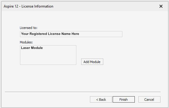

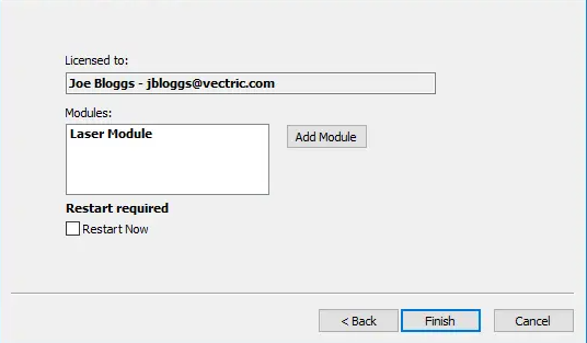

This page displays the selected license and module details. If you are changing current license details or adding a module a restart will be required for these to fully take effect. In this case a check box will appear allowing you to restart automatically. If this is checked then when you press Finish Aspire will automatically be restarted to apply the license changes. If you do not select this option the license changes take effect the next time Aspire is restarted.
Manual Method
The manual method allows entry of license details without requiring an Internet connection.

Adding Module
The summary screen shows the current licensed user and has an Add Module button to allow additional modules to be added. Pressing this button will display the manual entry form again and allow the module details to be entered.
If the licensed user is changed or a new module is added a restart will be required for these to take full effect. In this case a check box will appear allowing you to restart automatically. If this is checked then when you press the finish button the program will automatically be restarted to apply the license changes. If you do not select this option the license changes take effect the next time the program is restarted.
