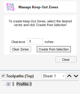

Zone Creation
Any vectors selected to represent areas where the machine should not pass over for the Keep-out Zones will need to be closed vectors.
If a vector you want to select for the Keep-out Zones is an open vector you will need to make it a closed vectors before selecting it, you can do this by using one of the close or join vector options in the Design tab.
Clearance
Enter a Clearance value if you need to extend the Keep-out Zone area beyond the area covered by the selected vectors.
Clear Zones
Use this to de-select all currently active Keep-Out Zones
Create from Selection
Create the Keep-out Zones from the currently selected Vectors, with the applied Clearance Offset.
Once created, Keep-out Zones are not linked to the Vectors used to make them and will remain even if the vectors are deleted.

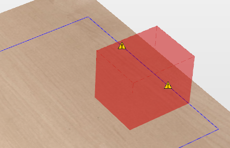

Toolpath Warning
If a toolpath is created which intersects a Keep-out Zones, then you will see a warnings in the 3D View and also get a warning popup to alert you of this.
