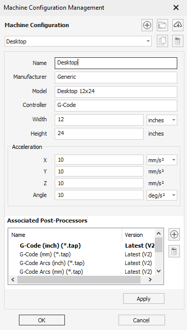

  3. List of Machines (Managed through the Machine Management dialog).

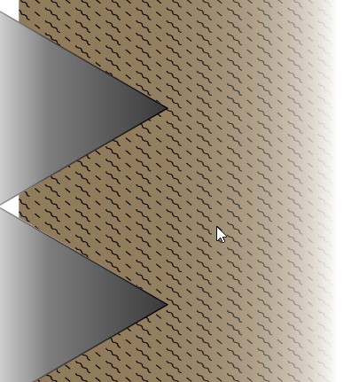

Like all other toolpaths the laser toolpaths can be simulated. However, in the case of laser toolpaths, the simulation does not remove any material but instead marks the surface of the current simulation model. This marking is meant to simulate the charring of the material when scorched by the laser.
Burn Rate 50
Burn Rate 100
Burn Rate 200

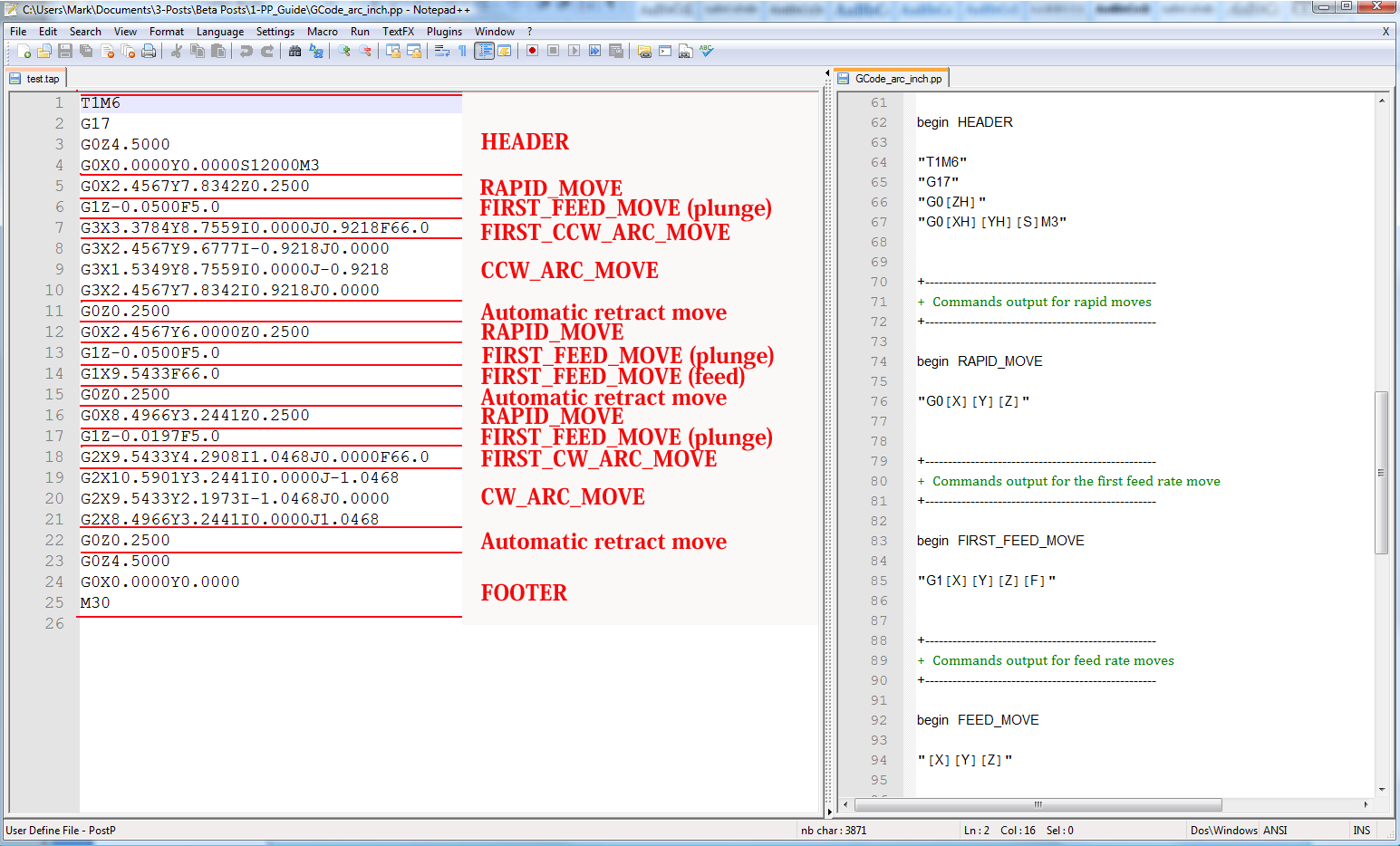

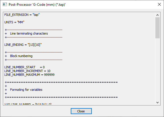

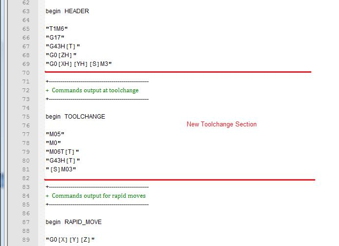

Adapting a post-processor for Lasers
Introduction
The Laser Module enables both new tool types to represent lasers in the tool database, and also new laser specific strategies.
The laser module now provides independent records and variables for laser tools and toolpaths. Because these outputs have been separated from conventional router control, for most machines and controllers it is often possible to create a single Post Processor to work seamlessly with router or laser toolpaths, but please note that you may still need to ensure that the physical configuration of your machine is changed depending on the toolpath type.
Previous Post Processors will not work correctly with the Laser Module
Please note that many conversion kit manufacturers provided Vectric Post Processors before the release of the Laser Module. These used workarounds to allow some router toolpath strategies, such as profiling, to be used with a laser head. Post Processors created without explicit support for the additional features documented here will not work correctly.
There are generally 4 areas that need to be modified in a conventional Post Processor to extend it for Laser toolpath support.

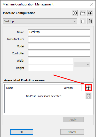

  • Add support for a new Power variable, which will be used by the new laser strategies.
  • Add new laser-specific Post Processor Blocks to format laser toolpaths correctly for your machine and controller.
  • Modify any existing Post Processor Blocks to ensure independent power and laser-specific behaviour.
  • Add a flag to tell Vectric's software that this post now supports laser toolpath strategies.
The following sections deal with each area in turn and an example using the GRBL gcode controller is provided. These examples are from the grbl (mm & inch) post processor provided by default with Vectric's software.
Power Variable
Vectric's software will output the power setting for a laser toolpath in the range of 1-100%. We need to add a new variable to show how to format this setting for your particular controller. This is also the opportunity to scale the raw percentage value to the numerical range that your controller requires.
Example
For GRBL-based controllers, the power setting for a laser is typically aliased to the gcode spindle speed control command 'S'. In laser mode, the controller will respond to a spindle speed control change by adjusting the power of the laser instead. Although it can be set within the controller, the default setting for the maximum expected 'S' value - or laser power - is 1000.
For GRBL, therefore, we need to format the POWER variable to be a gcode 'S' command and scale its output value by a factor of ten so that it is in the range of 1 to 1000 (instead of the default 1-100).
The variable entry in the Post Processor reads:
VAR POWER = [P|C|S|1.0|10.0]
To break this entry down in plain English, we are saying that the POWER output from our toolpath should be used everywhere in our subsequent post definition file where we have the the variable [P]. But we should only only output a command as the POWER value changes (C). We will replace the [P] variable locations in our our toolpath output with the command 'S' (S). The power value should be formatted as a whole number with no decimal points (1.0) and should be multiplied from its default by a factor of 10.
New Laser Post Processor Blocks
To allow Laser control, there are new Post Processor Blocks available in the Post Processor. These are:
  • JET_TOOL_ON - Output whenever the toolpath needs the laser on
  • JET_TOOL_POWER - Output whenever the toolpath needs the laser power to change
  • JET_TOOL_OFF - Output whenever the toolpath needs the laser off
Example
In our GRBL example we haved added the 3 new block types. For turning the laser on, GRBL makes use of gcode M4 command (normally intended for spindle direction, but 're-used' by GRBL for laser support ). We can now make use of our POWER variable, defined above as [P], to provide the required power value. The JET_TOOL_ON block is thus:
+ Commands output when the jet is turned on
begin JET_TOOL_ON
"M4[P]"
For turning the Laser off GRBL makes use of the gcode M5 command:
+ Commands output when the jet is turned off
begin JET_TOOL_OFF
"M5"
Finally for setting the power itself then for GRBL we just output the power:
+ Commands output when the jet power is changed
begin JET_TOOL_POWER
"[P]"
Modify Existing Blocks
We also want it to be the case that when we perform a feed move then we also output the power, so to do this we update the FEED_MOVE blocks to include [P].
We have to do that for all of the different feed move types.
In addition, we need to avoid plunge moves occurring when the laser is on. For conventional milling or routing, we need the spindle to be on before a plunge move, but for a laser it is crucial that we only turn it on after we have moved to the correct Z level (this problem manifests as 'overburn' at the beginning of each toolpath segement). To ensure that we can correctly separate these requirements, we may need to remove any spindle commands from plunge moves, or other block types (some may have them in the header, for example) and break these out into explicit SPINDLE_ON & PLUNGE_MOVE blocks. This will ensure that these moves are only made for non-laser toolpath strategies and in the correct sequence.
Example
For GRBL this is a simple addition to the end of the feed move statement:
+ Commands output for feed rate moves
begin FEED_MOVE
"G1[X][Y][Z][P]"
Remember that we set our POWER variable to only output on change (C) so note that in the output for feed moves at constant power, only an initial, changing, power command will be included. For some controllers, the number of commands that can be processed is a limiting factor on the speed of toolpath and for laser images, in particular, this can be mitigated somewhat by not sending uneccessary commands whenever possible.
For the separate GRBL spindle and plunge control the blocks are:

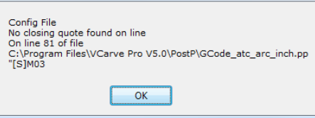

+ Command output after the header to switch spindle on
begin SPINDLE_ON
"[S]M3"
+ Commands output for the plunge move
begin PLUNGE_MOVE
"G1[X][Y][Z][F]"
You'll note that GRBL uses the M3 to control the router or mill. Also note that the plunge move requires the ability to move the machine in X & Y in order to support ramping.
Explicitly Mark the Post Processor as Laser Capable
Lastly a Post Processor will require the new Global File Statement LASER_SUPPORT="YES" added to be available for selection as a Laser Post Processor within the software.
This is only added to Post Processors for general use once the Post Processor has recieved complete testing by the creator.
Example
LASER_SUPPORT = "YES"

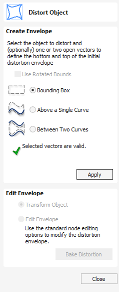

Distort Object
This tool allows you to bend and flex a vector or component by manipulating a distortion envelope using standard node editing tools. You can select one or more vectors or components and then use one of the three different tool modes to create your initial distortion envelope.
Multiple Objects
You can distort several vectors or components at once but you cannot distort a mixture of vectors and components together in a single operation.
Once the distortion envelope has been created, you can use the node editing tools to add or edit its nodes and spans. As you alter the shape of the envelope the associated object will be distorted to reflect the changes.
Layers
When distorting a selection of objects which fall on different layers, the result will be created on the layer of the first object in the selection.
Use Rotated Bounds
This option is only supported if you only have one object selected to distort. It makes use of the local rotation of the object as shown in the Selection Tool.
When this option is ticked,
  • The initial distortion envelope is created along the transformed bounds of the selected object.
  • When distorting along a curve (or two), the object is distorted on the curve in its local transformation. This is useful if you're distorting a rotated object onto a rotated curve, for example.
Bounding Box Distortion
This option is available if you have a selection of vectors or components (Note that you cannot mix vectors and components in this mode). It creates a distortion envelope based on the closest bounding box that can be drawn around your selection. Thus the resulting envelope is always initially a rectangle, comprising four line spans and a node at each corner. Using the normal node editing tools, however, you can modify this envelope as much as you like and the shape within it will be distorted accordingly.
Along a Single Curve
This option is only available if the last item in your selection is an open vector that can be used to define a curve, above which the other selected objects will be distorted. The distorted object can comprise one or more vectors or one or more components, but not both.
Using this option, you will usually end up with your objects bent to match the curve in your original selection. The distortion curve itself is left unchanged by this operation.
Between Two Curves
This option will become available if the last two objects in the current selection are open vectors, between which the other objects can be distorted.
Baking Distortion into an Object
Once an object has been distorted, node editing will always relate to the object's distortion envelope. If you wish to edit a distorted vector directly again, you will first need to permanently apply the distortion to the shape.
If you select an object that already has a distortion envelope while in the Distort Object tool, the Bake Distortion button will be available. Clicking this button will permanently apply your current distortion and you will then be able to either distort the object again (with new settings), or node edit the shape directly.

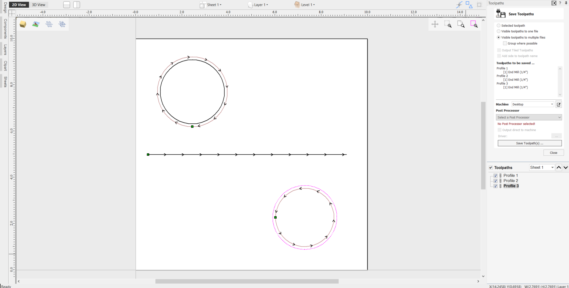

Save Toolpaths
This option allows toolpaths to be saved in the appropriate file format needed to drive the CNC machine. Toolpaths can be saved as individual files for each tool used or as a single file containing multiple toolpaths for CNC machines that have automatic tool changers.
Save Option
CNC machines that require the tooling to be changed manually will typically need a separate toolpath for each cutter used. The procedure for saving this type of toolpath is to:
  • Select the toolpath to save from the Toolpath List
  • Click on the Save option and the Save Toolpaths form is displayed.
  • Select the desired Machine from the pull-down list.
  • Select one of the Postprocessors associated with that machine from the pull-down list.
  • Click the Save Toolpath(s) button.
  • Enter a suitable Name and click the Save button.
Postprocessor selection and association
When Machine is selected from drop-down list, the Postprocessor list is updated to only show those relevant for the selected machine. Before this can happen Postprocessors have to be associated with given machine.
The Postprocessors can be associated with Machine using Machine Configuration Dialog that can be accessed by clicking on
You can also select <Add Post-Processors> option from the Postprocessor drop-down list to quickly associate Postprocessors with currently selected machine.
For more details please refer to Online Machine Configuration and Manual Machine Configuration.

Error Messages
The postprocessor automatically checks to ensure:
  • It has been configured for saving files that include ATC commands
  • A different tool number has been defined for each different cutter being used.
An error message will be displayed to indicate the problem if either of these items is not correct.

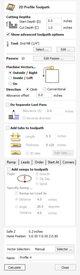

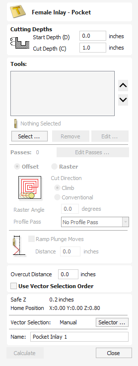

2D Profile Toolpath
Profile Machining is used to cut around or along a vector. Options provide the flexibility for cutting shapes out with optional Tabs / bridges plus an Allowance over/undercut to ensure perfect edge quality.
Profile toolpaths can be outside, inside or on the selected vectors, automatically compensating for the tool diameter and angle for the chosen cut depth.
When working with open vectors the profile toolpaths can be to the Left, to the Right or On the selected vectors.
Clicking this icon opens the 2D Profile Toolpath form which is shown at the right; the functions in this form are described on the following pages.
If you have vectors which are nested (like the letter 'O'), the program will automatically determine the nesting and cut the correct side of the inner and outer vectors. In addition, the program will always cut the inner vectors before the outer vectors to ensure the part remains attached to the original material as long as possible.
Cutting Depths
Start Depth (D)
Cut Depth (C)
Pass Depth Control
When a toolpath is created, the Pass Depth value associated with the selected tool (part of the tool's description) is used to determine the number of passes needed to profile down to the specified Cut Depth. However, by default the software will also modify the precise step down by up to 15% in either direction, if by doing so it is able to total number of passes required to reach the desired cut depth. It is nearly always desirable to benefit from the significantly reduced machining time of cutting using less passes if possible. Nevertheless, there are some occasions where the exact step down for a given profile pass needs to be more precisely controlled - when cutting into laminated material, for example. The Passes section page indicates how many passes will be created with the current settings.The Edit Passes... button will open a new dialog that enables the specific number and height of passes to be set directly.
Specify Pass Depths
To edit the depth of the selected pass, change the value in the Depth edit box and click Apply.
The Delete button will delete the selected pass.
The Clear All Passes button will delete all the passes.
To add a new pass, double left click at the approximate location in the passes diagram that you wish to add the pass. A new pass will be added and automatically selected. Edit the precise Depth value if required and then click Apply.
Pass Depth List Utilities
The first method simply sets the passes based on the Depth of Step property of the selected tool. By default, this is the method used by Aspire when initially creating profile passes. However, if the Maintain Exact Step Depth option is checked, the software will not vary the step size to try to optimize the number of passes (see above).
The second method creates evenly spaced passes based on the value specified in the Number of passes edit box.
To apply either method, click the Set Associated Passes button to create the resulting set of pass depths in the pass list and diagram.
Machine Vectors...
There are 3 options to choose from to determine how the tool is positioned relative to the selected vectors.
Outside
Inside
On
Direction
Can be set to either Conventional or Climb machining where the cutting direction depends upon the strategy selected - see above for details. Using Climb or Conventional cutting will largely be dictated by the material is being machined and the tooling.
Allowance offset
An Allowance can be specified to either Overcut (negative number will cut smaller) or Undercut (positive numbers will cut larger) the selected shape. If the Allowance = 0 then the toolpaths will machine to the exact size.
Do Separate Last Pass
A separate allowance can be specified for the last pass. If this allowance is given then all but the last pass will be undercut by the specified allowance with the final pass being the only pass which cuts to size.
This is intended to be just a thin skin of material to be cut away as the tool will have to cut through this allowance at the full depth of the cut where all the previous passes undercut. There will be a warning displayed if the last pass allowance is greater than 1/3rd of the tool diameter but the last pass allowance should ideally be kept a lot smaller than this. Keeping this as small as possible reduces the chances the final pass will fit in areas where the previous passes will not and reduces the amount of material the last pass is having to cut through. If using a last pass allowance for the toolpath you should check that you are happy with the amount of material left for the last pass to cut through. The toolpath will fail to calculate if the last pass is cutting a significant distance into material which has not been cleared by the previous passes.
If the Reverse direction button is checked ✓ then the cutting direction of the last pass is reversed. This feature is can be useful if for minimizing witness marks on the edge of profile cuts.
The last pass allowance will also take into account any allowance offset and so the two options can be used together.
Use Vector Start Point
Use Start Point can be selected to force the toolpath to plunge and start cutting at the first point on the shape. This is very useful if you need to ensure the cutter doesn't plunge onto a critical part of the job. For example, setting the Start Point to be on a corner will often be the best position to plunge and cut from as this will not leave a witness / dwell mark on the machined surface.
The Start Points are displayed as Green boxes on all vectors when this option is selected. Start Point on a vector can be moved using the Node Editing Tools. Select Node Editing cursor or press N. Place the cursor over the node to be used as the Start Point. Click Right mouse button and select Make Start Point (or press P) Remember, you can also insert a new point anywhere on a vector using the Right mouse menu or pressing the letter P - this will insert a new point and make it the start point.
Selecting Use Start Point may result in less efficient toolpaths (increased cutting times) because it may take the machine longer to move between each shape being cut. If this option is not selected the software will try to calculate the shortest toolpath, minimizing the distance between link up moves. But the downside is that the cutter may plunge/mark important surfaces on the machined edge.
Tabs (Bridges)
Tabs are added to open and closed vector shapes to hold parts in place when cutting them out of material.
Add tabs to toolpath
Checking ✓ the Add tabs option will activate tab creation for this toolpath. The Length and Thickness specify the size of each tab. Checking ✓ the Create 3D Tabs option will create 3D Tabs, the difference between this and 2D Tabs is described below.
Create 3D Tabs
When this option is selected the tab will be triangular in section. This is shape is created as the cutter ramps up to the specified Tab Thickness then down the other side. The 3D Tabs will often allow the machine to run quicker and smoother because it does not have to stop to move in Z at the start and end of each tab.

The Profiling options section of the toolpath form contains five additional pages, each of which allows a particular set of Profile machining options to be specified. The precise number of option pages will depend on which Toolpath strategy you are currently using. The full range of option pages are:
  • Ramps
  • Leads
  • Order
  • Start At
  • Corners
These help control ways to ensure the parts are held in place and machined as easily as possible while ensuring the highest quality edge finish.
Each set of options can be accessed by the tabs at the top of the Profile options section.
Ramp
Ramp moves are used to prevent the cutter from plunging vertically into the material. The cutter gradually cuts at an angle dropping into the material significantly reducing cutter wear, heat build-up and also the load on the router spindle and Z axis of the machine. If multiple passes are required due to the Pass Depth being less than the Cut Depth, the ramp moves are applied at the start of each level. All ramp moves are performed at the plunge rate selected for the current tool.
Smooth
This option creates a smooth ramp into the material using either the specified Distance or Angle.
When a Lead In distance has been specified, the option Ramp on Lead In disables the distance and angle options and automatically limits the ramp moves to only be on the lead in portion of the toolpath.
Zig Zag
This option ramps into the material by Zig-Zag backwards and forwards using either the specified Distance or Angle and Distance.
The Distance option ramps into the material, zigging for the specified distance in one direction then zagging back over the same distance.
The Angle option is typically used for cutters that cannot plunge vertically but have an entry angle specified by the manufacturer.
Spiral
Checking ✓ this creates a continual spiral ramp, these are only available when the toolpath does not include lead in moves.
This option ramps into the material over the complete circumference of the profile pass. The angle is automatically calculated to ramp from the start point to full depth over the perimeter distance around the job.
The rate at which the cutter ramps into the material is determined by the Pass Depth specified for the cutter. For example, Spiral Profiling 0.5 inch deep with a cutter that has a Pass depth of 0.5 or greater will spiral down in 1 pass. Editing the Pass depth to be 0.25 inch results in the 2 spiral passes around the profile.

Machine Acceleration
Using the Machine Acceleration values will allow you to get a more accurate time estimation.
This will calculate the speed the machine will be able achieve up to the feedrate of the toolpath, based on the acceleration settings given.
For accurate Acceleration values of your machine, contact your machine supplier.
Machine
Select the machine you with to use the Acceleration values from the dropdown menu.
If you need to adjust the Acceletation options for a machine, you can use the link to the Machine configuration tool

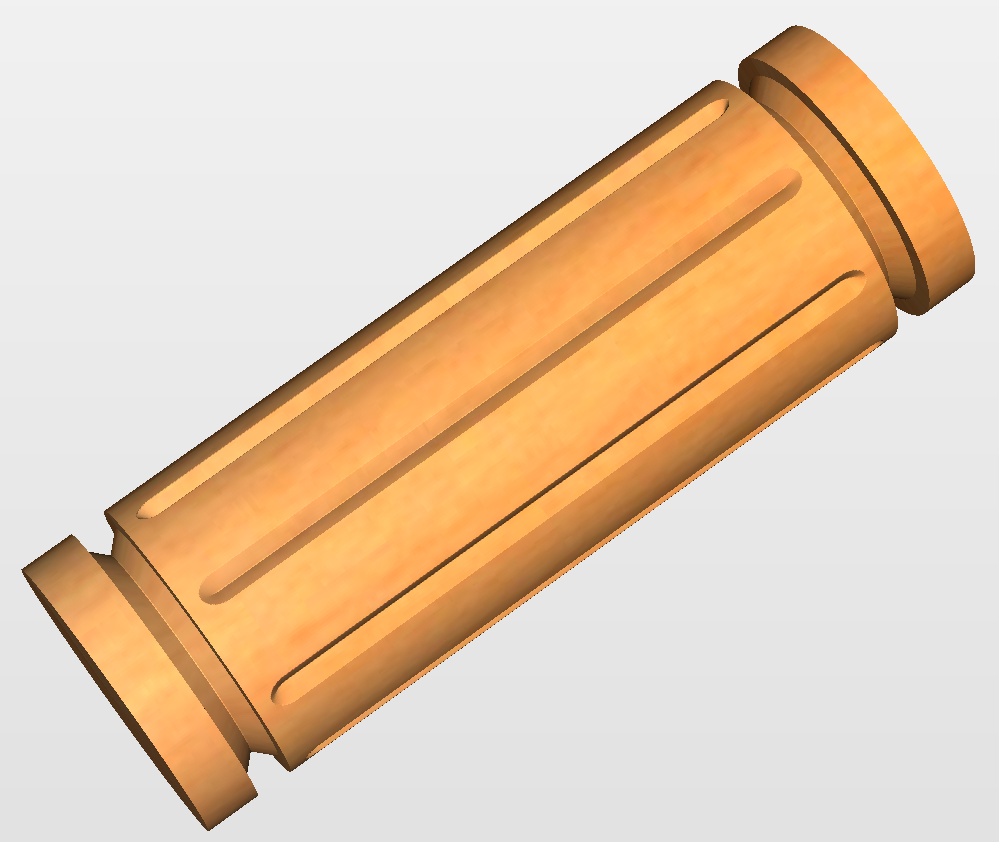

This section will show how to create a simple column, using the profile and fluting toolpaths.
Start by creating a new rotary job. Please note that settings shown here are only an example and should be adapted to match your machine setup and available material.
In this example the blank will rotate around X axis. We will refer to it as the rotation axis. The axis that will be wrapped is the Y axis. We will refer to it as the wrapped axis. That means that the top and bottom boundaries of the 2D workspace will actually coincide. We will refer to them as the wrapped boundaries.
First, create the cove vectors using Draw Line/Polyline tool. Those will run along the wrapped axis at both ends of the design. Snapping may be useful to ensure that the created line starts and ends at the wrapped boundaries.
In this example the coves were placed 1 inch from the job boundaries, leaving 10 inches in the middle for the flutes. The flutes will run along rotation axis. Assuming 0.5 inch gap between the cove and the beginning of the flute, the flutes will have the length of 9 inches. This example will use 8 flutes.
To start, create a line parallel to rotation axis that is 9 inches long. Now select the created flute vector and then select one of the cove vectors while holding down Shift. Then use Copy Along Vectors tool to create 9 copies. The original flute vector may now be removed as it is no longer necessary. Note that first and last copy are both created on wrapped boundaries. That means they will coincide, so one of them can be removed. As the last step select all flute vectors and press F9 to place them in the center of design.

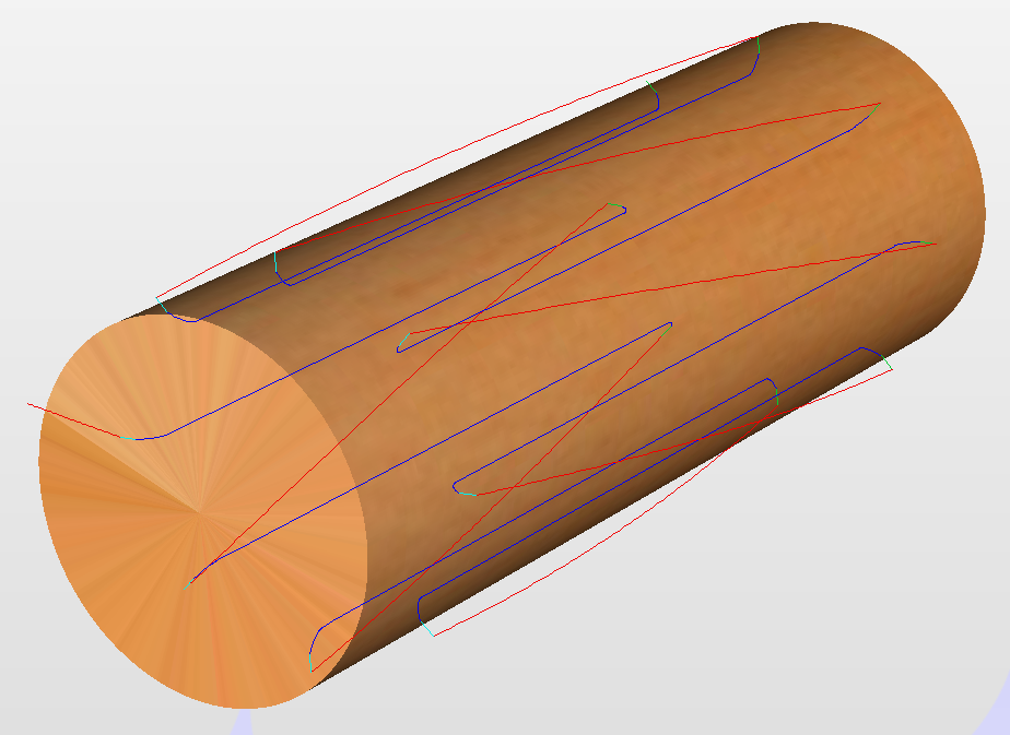

Creating rotary toolpaths
The process of creating 2D rotary toolpaths is very similar to creating toolpaths for Single - and Double - models. This example will use the profile toolpath on the cove vectors. To create the toolpath, select the cove vectors and click on the Profile Toolpath from
To create the toolpath for the flutes, select the flute vectors and click on the Fluting Toolpath. This Example used a 1 inch 90deg V-Bit set to Flute Depth 0.2 and using the Ramp at Start and End and Ramp Type Smooth options. Ramp length was set to 0.25 inches. Both toolpaths can be seen below.
Simulating and saving toolpaths
It is time to simulate toolpaths using Preview Toolpaths. If the option to animate the preview is selected, the simulation will be visualized in flat mode. Once the simulation is complete, the wrapped rotary view will be turned back on automatically.
Contrary to single - and double - sided simulation, rotary simulation is not 100% accurate. For example round holes will appear in rotary view as oval ones, but obviously will be round when part is actually machined.

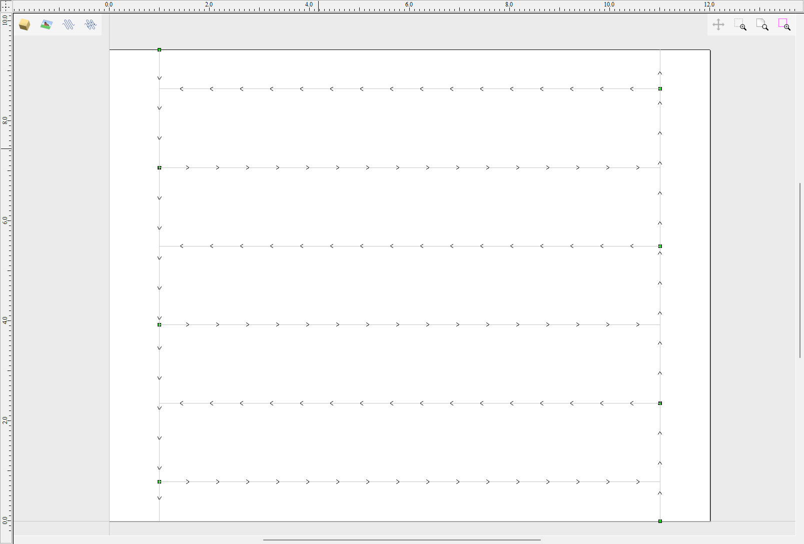

Spiral toolpaths
This section will explain how to create and simulate spiral toolpaths.
One way of thinking about spiral toolpaths is to imagine a long, narrow strip of fabric. Such a strip can be wrapped around a roll at a certain angle. In order to create a toolpath that wraps around the blank multiple times, one can create a long vector at a certain angle. Such a vector is an equivalent to the strip of fabric when it is unwrapped from the roll.
Although such a toolpath will exceed the 2D workspace of the rotary job, thanks to the wrapping process during both simulation and machining the toolpath will actually stay within material boundaries.
The most crucial part of designing spiral vectors is to determine the right angle and length of the line that would result in a given number of wraps. Suppose one would like to modify a simple column design to use spiral flutes, rather than parallel to rotation axis. The following example will use flutes wrapping 3 times each, but the method can be adapted to any other number.
All but one of the existing flute vectors can be removed. Select the Draw Line/Polyline and start a new line by clicking at one end of the existing flute. This line needs to be made along the wrapped axis with the length being 3 times the circumference of the job. In this example that means typing 90 into the Angle box and typing y * 3 into the Length box and pressing =. If the wrapped axis is not the Y axis, but rather the X axis, then the above formula should be x * 3.
Now one can simply draw a line connecting to the other end of the original flute vector and the newly created one. Using Copy Along Vectors tool this single flute may be copied in the way described earlier. In this example 4 spiral flutes were created, as can be seen below.
Vectors used to create spiral flutes
Spiral toolpaths in flat view
Once the flute vectors are ready, the toolpath can be created again using the Fluting Toolpath. An important thing to note, is the difference between the appearance of spiral toolpaths in the wrapped and flat view. By clicking on Auto Wrapping one can switch from wrapped rotary view to flat view and back again.
As can be seen above, in the flat view the toolpaths will follow the vectors and extend beyond the job boundaries. On the other hand the wrapped view, presented below, will display the toolpaths spiralling around the blank.

Getting Started: Online Machine Configuration
We are providing a selection of prepackaged machine configurations for the most popular machine manufacturers and the list is continually growing.
This will take you to the Search Machine Online dialog. If you find and download your machine, it will be imported into your tool database with some initial feeds and speeds for a set of tools. It will also be associated with the post-processors compatible with it.
This can all be done or edited later on through the Machine Configuration dialog.
Can't find your machine?
If you can't find your machine, you can configure it manually in the next step, or later on through the Machine Configuration Management dialog.

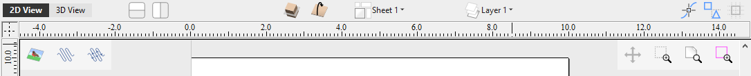

Above the view windows is the main toolbar which allows you to navigate through the structure of your CNC job and see what is currently being displayed in view windows below. It shows you the material sheet, design layer and 3D model level that you are currently working on (referred to as 'active').
What you see in the 2D & 3D design views below will reflect these current settings and any new shapes, components or toolpaths will be created in the active locations indicated. You can also change the active sheet, active layer or active level at any time directly from these controls.
More advanced projects can also represent both sides of a sheet of material. For a two-sided project an additional control above the views shows which side of the sheet is currently active. You can view the drawings, models and toolpaths associated with the top and bottom surface of each material sheet and swap the active side of the sheet in a consistent way to the other controls.
Initially your job will be empty and so your views will be blank, but in due course, Vectric's view windows will show all the layered drawings & images, 3D model components & toolpaths for the currently active material sheet.
The currently active locations are the same for both the 2D & 3D views i.e. creating a vector shape will place it on the same active sheet and active layer regardless of whether the 2D or 3D view is used.
You can, however, toggle the visibility of object types in each view independently using the visible items toolbar at the top of each view. This is helpful for focusing on different areas of your job at each stage of creating your CNC project.

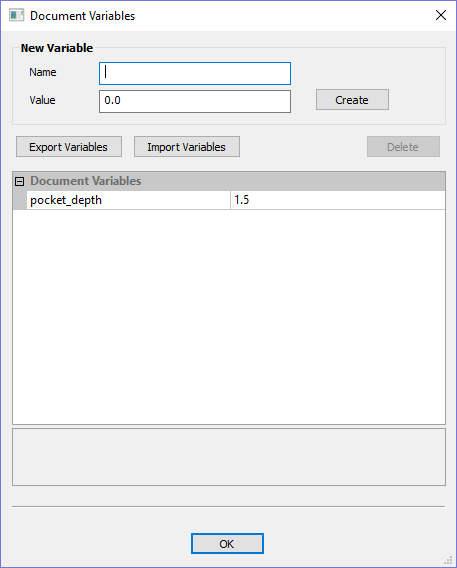

Document Variables
Opens the Document Variables dialog.

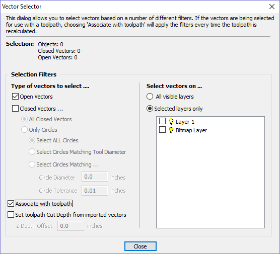

Vector Selector...
Opens the Vector Selector dialog.

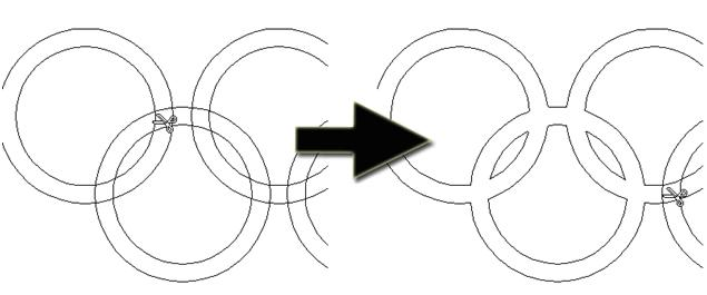

Overlap Vectors
Selected closed vectors that overlap can be merged together to create a new shape. These tools consider the closed vectors to be solid areas.
The following examples begin with these five vector shapes where the rectangle was selected last.

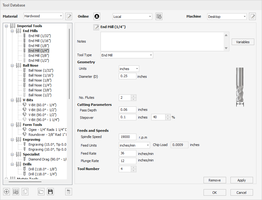

Tool Database
Configuring the software will create a default tool database with tool definitions include cutter movement speeds ("feedrates") that *should* be a reasonable starting point for you to edit the entries for the tool types that you have, according to the recommendations from your CNC machine manufacturer for each material. Appropriate tool settings are the result of a complex interaction of the tool's shape and design, the nature of the material you intend to cut and the strength and power of your CNC machine. Don't use any default settings without first considering whether they are appropriate for your circumstances.
We will look at the Tool Database in more detail in the Toolpath Creation section below.
Post Processors
Your software can create toolpath files for hundreds of different CNC machines and controllers. To achieve this, the software creates an internal representation of a toolpath. Only when this toolpath is saved does it get 'translated' into the specific format required by your CNC machine.
The translation instructions are contained in file called a Post-Processor (because it *processes* the toolpath *after* it has been created).
Post-Processors also determing whether the toolpath movements will be presented to the machine using metric or imperial units. This must typically match the units mode you have set on your CNC machine's controller (seek advice from the manufacturer if needed). Note, however, it doesn't matter what units where used to create the original toolpath within the software - any required conversion is automatically applied when the toolpath is saved through the Post-Processor.

Document Variables
Document Variables provide a mechanism for defining values that can be used in Cut2D Desktop's Document Variables. They can either be created in the Document Variables dialog which is accessible under the Edit menu, or created from any Calculation Edit Box which supports variables by right clicking and selecting Insert New Document Variable from the Popup Menu.
Naming Document Variables
New Document Variable names must begin with a letter and then may consist of letter, number and underscore characters. Once created, they may be edited in the table beneath the New Variable section of the Document Variables Dialog.
Variables can be exported to a text file and imported into another job. When importing, any existing variable values with the same name will be replaced.
Deleting Document Variables
Variables may be deleted if they're not being used in any toolpath calculations but only when there are no toolpath creation forms open.
Using Document Variables
Once created a Document Variable may be used in any Calculation Edit Box by enclosing its name within a pair of curly braces as illustrated in the figure below.
Right clicking in a Calculation Edit Box provides a Popup Menu that provides shortcuts for creating new Variables and inserting existing variables into the Edit Box.
Once a Document Variable has been created from the Popup Menu it will be inserted into the Edit Box.
Accessing Document Variables
Declared Document Variables can be easily accessed from a calculation edit box. Right-click on the calculation edit box and you will be presented with a menu showing the document variables available currently, as well as an option to quickly insert a new document variable.
If you have downloaded a machine configuration and would like to edit it, or you would just like to create a new machine then you can do so from Machine Configuration Dialog.
This will allow you to edit, duplicate, add or remove machines. It will allow you edit the post-processor associations for each configuration.
  1. Having a machine configuration allows you specifiy different feeds and speeds for your tools in the Tool Database.
  2. And then it will allow you to easily select a machine to save your toolpaths with later on.

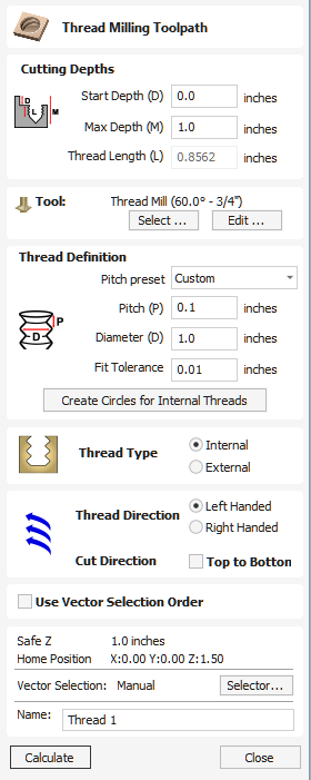

Thread Milling Toolpath
The Thread Milling Toolpath produces:
  • internal thread, i.e., something you can screw a threaded bolt into.
  • external threads, i.e., the threads for the exterior of a bolt.
It does this by using a special physical tool and a helical toolpath.
To use the toolpath select the vectors you wish to create threaded parts for. The center's of these vectors will be used to define the center of the threaded part.
Set the parameters to match the thread type you require, and then hit calculate to create the toolpath.
Cutting Depths
Start Depth (D)
Start Depth (D) specifies the depth at which the Thread Milling toolpath is calculated from. When cutting directly into the surface of a job the Start Depth will often be Z0. If machining into the bottom of an existing pocket or stepped region, the depth of the pocket/step that you are starting from must be entered here.
Max Depth (M)
Max Depth is the deepest depth below the Start Depth the Threading will cut down to.
Thread Length (L)
The Thread Length is how deep into the thread hole the threads will cut down too. This value will always be less then the Max Depth and is auto calculated from the Max Depth and the Tooth Offset of the Threading tool you are using, and the Pitch of the thread.
Tool Selection
Clicking the Select button opens the Tool Database from which the required Tool can be selected.
Clicking the Edit button opens the Edit Tool form which allows the cutting parameters for the selected tool to be modified, without changing the master information in the database.
The thread milling toolpath supports two types of tool:
Single Point tools have a single point for cutting a single thread at a time
Multi-Point tools have multiple cutting teeth. They will cut all the threads with a single rotation

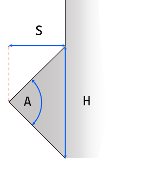

Single Point Tools
When using a single point tool then the created toolpath form a helix. The cutter at the side removes stock material to form the thread.
As seen in the above diagram, a single pointed thread mill tool is assumed to have a triangular cutting face. This triangle is the part of the tool that stands out from the shank of the tool and removes material:
The definition of the tool requires the following fields:
  • S - The Tool Size. The horizontal size of the cutting part of the tool
  • H - Tool Height. This is the vertical height of the widest part of the cutter face
  • D - Tool Diameter. The diameter of the cutter measured from tip to tip.
  • A - Tool Angle. The internal angle of the tool
  • O - Tool Offset. This is the distance between the bottom of the tool and the tip of the cutter. It must always be bigger than the half of the tool size. Some tools may also have an additional offset, so it may exceed this value.
The Tool Height, Tool Size, and Tool Angle are all related fields. Changing one may change another. For example, if you modify the Tool Height, and the Tool Angle does not change, then the Tool Size must change. This change happens automatically when editing the tools within the tool databse.
Multi Point Tools
It is possible to use a multi-pointed tool for thread milling. A multi-pointed has been designed to cut a single style of thread using a single helical motion. It will cut all the threads in a single go making it more efficient. However unlike single point tools it cannot cut different threads of different pitches.
In addition to the dimensions required for the single pointed tool, the multi-point tool also needs to know the threaded length. This is defined as the distance from peak to peak from the first cutting tooth to the last.
Advantages and Disadvantages
  • Single point tools have more flexibility when it comes to the threads that they can cut. The cutting paths can compress or extend to create threads with different pitches.
  • Single point tools will be slower. They must machine all the threads with the one cutting edge, so will be many times slower than the equivalent multi-threaded tool.
  • For large wood-working style jobs then it is unlikely that you will find multi-threaded tools of the right size.
  • For cutting standard sized threads then a multi-threaded tool will be correctly spaced and easy to use.
  • In the software, with a multi-point tool you cannot alter the pitch, and the toolpaths thread length must be at most the thread length of the tool.
Thread Definition
Pitch Preset
You can choose from one of a number of standard presets for the pitch. The standards are based on the ISO Metric Thread Standard for metric units, or the Universal Thread Standard for imperial units.
Selecting one of these options will pre-populate the pitch field with the correct value. If an external thread is selected it will also populate the fit tolerance field with a default value appropriate for the pitch. You are free to change this tolerance, however some tolerance will usually be required to have a smooth spinning thread.
Pitch
The Pitch describes the difference between the ridges of the thread.
Diameter
Each thread has two diameters associated with it. These are the respective peaks and troughs of the thread.
The diameter on the form (sometimes referred to as the major diameter) is the largest diameter associated with the thread.
Fit Tolerance
The fit tolerance controls how tight a fit the thread will have. Setting a positive tolerance will mean the tool cuts a slightly deeper thread.
In almost all practical uses, some form of fit tolerance would need to be applied in order to get a thread to run smoothly. Generally the fit tolerance is applied to the external thread but can be applied to both internal and external if needed.
Create Circles for Internal Threads
When cutting an internal thread you may have an area inside that thread that needs to be removed with another tool. Calculating what area can be safely removed can be a little bit of work, so to make that easier the Create Circles for Internal Threads button will create a circle that the user can apply a Pocket toolpath to, to clear this region.
Thread Type
There are two different types of thread it is possible to create:
  • Internal Threads - These are threads for the female parts of connectors, e.g., nuts, threaded holes.
  • External Threads - These are the threads for the male parts of connectors ,e.g. bolts.
Direction
Thread Direction
A thread can be either right-handed or left-handed. This determines the clockwise/anti-clockwise direction of the thread as it spirals.
Cut Direction
The cut direction determines whether or not we want to machine the toolpath by sprialling downwards or upwards.
Which direction you choose will depend in some part on the relationship between the spindle direction, the tooling, and the desired finish.
Created Threads
The threads created by the Thread Milling toolpath are based around the ISO standard for threads. More information about this standard can be found here. This is based on tools with 60 degree angles and whilst we do not prevent other angles of tools from being used a 60 degree tool would give optimal results.
The result of using this standard is that the created threads will have flat regions as expected:
Use Vector Selection Order
If this option is checked, ✓ the vectors will be machined in the order you selected them. If the option is not checked the program will optimize the order to reduce machining time.
Delete Toolpath
This tool is used to delete calculated toolpaths from the Toolpath List. Simply select the toolpath to be deleted and click the Delete Toolpath button to remove it.

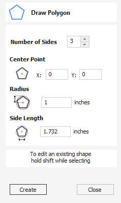

Draw Polygon
Polygons (e.g. Triangles, Pentagons, Hexagons etc.) can be created interactively with the cursor and Quick Keys or by entering the number of sides, exact coordinates and radius using typed input.
Interactive Creation
The quickest and easiest way to draw a polygon is by using the mouse in the 2D View.
  • Click and hold the left mouse button to indicate the center point.
  • Drag the mouse while holding down the left mouse to required radius.
  • Release the left mouse button to complete the shape.
Holding ALT and dragging creates a polygon from the middle point.
Quick Keys
Instead of releasing the left mouse button when you have dragged your shape to the required size, you can also type exact values during the dragging process and set properties precisely.
  • Left-click and drag out your shape in the 2D View.
  • With the left mouse button still pressed, enter a quick key sequence detailed below.
  • Release the left mouse button.
Default
By default, entering a single values will be used to set the radius of your polygon. While you are dragging out the polygon, type Radius Value Enter to create a polygon with the precisely specified radius.
Example
  • 2 . 5 Enter - Creates a polygon with a radius of 2.5. All other settings as per the form
Specifying Further Properties
By using specific letter keys after your value, you can also indicate precisely which property it relates to.
  • Value D - Creates a polygon with the diameter specified, with all other properties as per the form.
  • Value S Value R - Create a polygon with the specified number of sides (S) and the outer radius (R)
  • Value S Value D - Creates a polygon with the specified number of sides (S) and the outer diameter (D)
Examples
  • 1 R - Outer radius 1, number of sides as per form
  • 1 D - Outer diameter 1, number of sides as per form
  • 8 S 1 R - An 8 sided polygon with outer radius R of 1
  • 6 S 2 . 5 D - A 6 sided polyon with an outer diameter of 2.5
Exact Size
Polygons can also be drawn by entering the required XY origin , selecting either Radius or Diameter and entering the required size.
Click Apply to update the circle
Editing Existing Polygons
To edit an existing polygon select the polygon, edit the parameters and click Apply to update the circle.

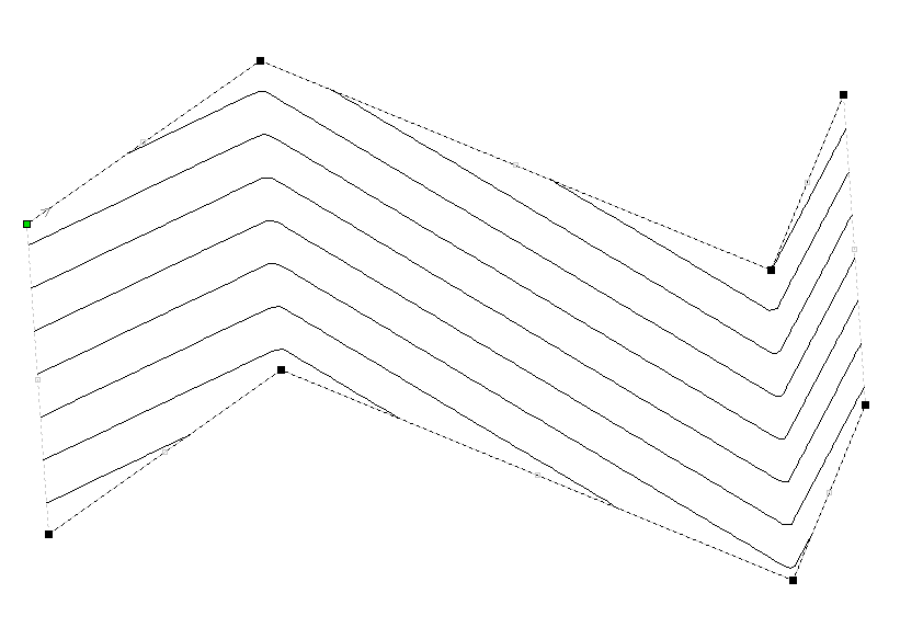

Offset Vectors
Selected vectors (open or closed) can be offset either inwards or outwards to create new vector shapes that might be useful for edge patterns or borders etc. To offset a vector shape, use the following steps:
  • Select the vectors to offset
  • Select the required direction - Outwards / Right or Inwards / Left
  • Enter the Distance
  • Click the Offset button
Options
The offsetting options are slightly different in their behavior depending on whether the vector to be offset is open or closed. See below for more information.
Create sharp offset corners
Will retain any sharp corners in a design.
Offset with Sharp Corners on
Offset with Sharp Corners off
Offsetting Open Vectors
When offsetting open shapes, the options are either to the Right or Left side of the selection. The direction of open vector(s) is very important as this is used to decide the right and left side of the selection. Selecting Node Edit mode (pressing N on the keyboard) will display a Green node at the start of the vector. Looking along the vector(s) from the green node indicates the direction and the image below shows offsets to the left and right of an open vector.

Post-Processor Change Log
This will provide details of the changes that have been made between versions of this post-processor. This may be important for determining if you need to use an ealier or later version of a particular post-processor for your machine tool or controller.
This can be accessed from the Post-Processor list in the Machine Configuration Management dialog or the Post-Processor Management dialog.
Vector Selector
This tool allows you to easily select vectors which meet a set of criteria, such as open, closed, circular and also matching constraints based on layers. The dialog can be accessed from the Edit ► Vector Selector menu item, or from the Selector... button on each toolpath form. When the command is executed the dialog shown is displayed.
The dialog is used to configure a set of 'filters' that determine which vectors will be selected. A filter is enabled by clicking on its check box, or selecting a 'radio button' option, the current selection will be updated with all the objects in the file which match the current filter options.
Generally you will start at the top of the dialog and work downwards, specifying more and more explicit filters to determine the required selection exactly.
The simplest option is just to use the form to Select Closed Vectors in the job or Select Open vectors (you can specify both, in which case all vectors will be selected as long as they are on a visible layer).
The most common way to use the Vector Selector is to select all the vectors on a given layer as shown in the screenshot of the dialog below.
When opened from Edit ►Vector Selector, the options Associate with toolpath and Set toolpath Cut Depth from imported vectors are not available. These options are only usable when applying the vector selector from a toolpath form.
Selection
The Selection: section at the top of the dialog is continuously updated to show the results of the current filter and the 2D view is also updated to show what is currently selected. The Objects: entry shows the total number of objects selected, if these objects include Text or Groups, this number may be less than the total of Closed and Open vectors displayed on the following line. For instance, a block of text is one object but will usually consist of many closed vectors. If a group contains both open and closed vectors, it will be selected as matching both Open and Closed filters.
Geometry Filters
The Geometry Filters section is used to specify constraints on the type of vectors to select. You can choose to select open vectors and/or closed vectors. Instead of selecting All Closed Vectors, the dialog can be used to select Only Circles and can even be used to specify an exact diameter and tolerance for the circles to be selected. This can be very useful for selecting vectors for drilling toolpaths, particularly if the vectors have not already been sorted into layers.
Layer Filter
The Layer Filter section allows you to pick one or more visible layers on which to select vectors which match the geometry filter. Alternatively, the All visible layers option disables the filtering by layer and selects all vectors which match the geometry filter regardless of the layer they are on, as long as that layer is visible.
Advanced Toolpath Templates
By associating a template with the result of a Vector Selector filter, we can make a template to automatically select the vectors it is intended to machine. A simple case would be to create a template which consisted of a Pocketing toolpath set up to machine all closed vectors on a layer called Pocket. After loading this template into a new job and choosing Toolpaths ► Recalculate All Toolpaths , the toolpath would be recalculated automatically selecting all closed vectors on the layer called Pocket.
The advanced templates are created by selecting the vectors for a toolpath using the Selector... button on the toolpath form. When a toolpath form is first opened, the Vector Selection: section on the form will show that vectors are being selected manually as shown below...
Pressing the Selector... button will display the Vector Selector form as shown previously. After making your geometry selection and before you close the form, select the Associate with toolpath option on the form as shown below.
After the Vector Selector form closes, the Toolpath form will indicate that Vector Selection is now 'Automatic' as shown below...
Calculate the toolpath to apply the changes you have made.
When you re-calculate or edit a toolpath that has the Vector Selection mode set to automatic, the vectors which match the filter when the toolpath is re-calculated or edited will be selected. To cancel the Automatic vector selection mode, you can just select the vectors to machine normally with the mouse, or use the Selector... button to bring up the Vector Selectordialog again (the settings are remembered) and uncheck the Associate with toolpath option.
If toolpaths with the Vector Selection mode set to Automatic are saved as templates, these setting are saved with the template. When the template is re-opened and the toolpaths recalculated, they will automatically select all vectors which match the filters specified with the Vector Selector for that toolpath.

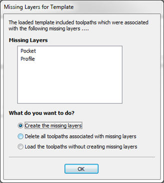

If you load a toolpath template which has toolpaths associated with layers which don't exist in the current file, the Missing Layers for Template dialog will be displayed. It lists all the missing layers and offers you the choice of having them created automatically, deleting toolpaths associated with missing layers or just loading the toolpaths as is.
Choosing to allow the dialog to automatically create the missing layers allows a toolpath template to be used to create 'standard' layers for machining operations and load the toolpaths ready to be calculated. All you then need to do is move vectors to the appropriate layers and recalculate all the toolpaths.
Choosing the Delete all toolpaths associated with missing layers option allows you to create a single template with many toolpaths and have the ones which aren't appropriate to the current job automatically deleted.

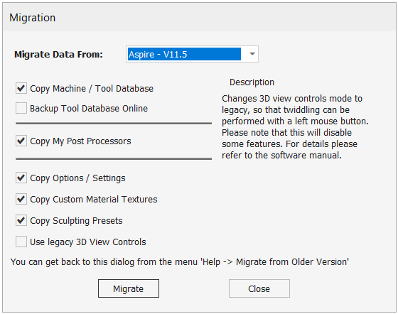

This gives you the option to use the Modern Mode or Legacy Mode for the 3D view controls.
Modern Model use the right mouse button to move the 3D view.
In Legacy Mode you retain the ability to move the 3D View using the left mouse button.
Please note that if the Legacy 3D view control is selected that some features in the 3D view will not be available.

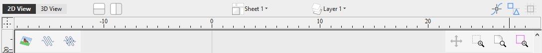

View Toolbar
Above the view window is a handy toolbar that allows easier access to common tools. With the ability to create a double sided project you have easy access to switch between the Top and Bottom Sides of your project. The Layers, Sheet and Level Drop down bar have now moved from the tabs onthe left to the View Toolbar, making it accessible at all times. The other icons displayed in order of left to right are as follows
Tile 2D & 3D View Windows
Stack 2D and 3D View windows vertically
Stack 2D and 3D View windows horizontally
Visibility Options
Toggle bitmap visibility
Toolpath Drawing Toggle
Toggle 2D Toolpath Drawing
Toggle solid 2D Toolpath Drawing
Drop Down Sections
Sheet drop down bar
Layer drop down bar
Snapping Toggle Options
Snap to geometry
Smart Snapping
Snap to Grid
View Controls
Toggle Pan / Twiddle View
Zoom to box
Zoom to show all Drawing (Shift to Zoom to Drawing on Active Sheet)
Zoom to selection
Two-Sided Machining
When you are working on a two-sided job additional icons will appear on the View Toolbar. You will see an icon indicating whether the job you are working on will be flipped horizontally or vertically. This is important because the software will automatically mirror your toolpaths and geometry around different axes depending on this setting. To maintain the correct alignment of your toolpaths you must physically turn the material on your CNC machine in the same direction as you have specified during the design process.
The next icon indicates which side you are currently working on. This can also be clicked on to toggle between the single sided view or two sided view.
The rulers that border the 2D View are colored to provide a handy visual indicator as to which side is currently active. An Orange background indicates that the Bottom side is currently active and any drawing or toolpaths are associated with the Bottom Side of your design.

Migrating Post-Processor POST_BASE
Prior to V11.0, we had the POST_BASE global variable as a way alleviating some of the repetitions inherent to post-processors to make their management and organisation easier. This seemed to create trouble over the years, so we have stopped supporting it.
This guide will help migrate from some of the old post-processors.
Default Post-Processors
If you have not made any changes to your post-processor, you could find it again in the Vectric shipped database in the Post-Processor Management dialog and simply click 'Customise' to add it again to your My_PostP folder.
For the purpose of this guide, we will demonstrate this on the Next Wave post-processor, but the guidelines here can be applied to any post-processors.
The base does not need to change
In this guide, we will go through how to replace the POST_BASE statement. We will never have to alter the base post-processor (referenced in that statement), but only the post-processor containing that statement. Please always back up your file first.
Check your output
Save some toolpaths using this new post and check the output!
What is a Base Post
In previous versions of the software then it was possible for a post-processor to have a base post-processor. The base post-processor had common sections in it. Then any other post-processor could take this post-processor as it's starting point, overwriting the bits it needed to. In this case we would say that this new post-processor inherited the base post-processor.
Summary of Migration
Assuming a post-processor Next_Wave_CNC_mm.pp which inherits the Next_Wave_CNC.pp post-processors:
The syntax of a typical POST_BASE statement is POST_BASE = "Next_Wave_CNC.pp"
Since this is no longer supported, we would need to replace this statement with the contents of Next_Wave_CNC.pp, removing any duplication from the copied content.

Click on the Profile Toolpath button to open the 2D Profile Toolpath form.

Post-Processor Management...
Gives a list of all installed Post Processors and allow the user to Check the Changelog, Customise a duplicate of a Post Processor or simply View the Post Processors current formatting.
This dialog is used to edit and manage the list of machines for use in the tool database. It is also used for associating post-processors with those machines for use in Toolpath Saving. It can be accessed through the Machines Menu, the Tool Database dialog, the Toolpath Saving form, and the Estimating Machining Time form.
Machine List
List the machines added to the database. Selecting a machine activates it. This allows it to be edited in this dialog. In the Tool Database dialog, it results in switching the cutting data of the tools to be the set defined for the active material / machine (if any).
Add Machine
Add a new machine to the database and makes it active ready for editing.
Install Offline Package
Allows you to install a machine package which was downloaded from your V&Co account. If you are online, it may be better and more convenient to use the Search Machine Online tool directly from within the software.
Machine packages are preconfigured machine configurations which come pre-associated with compatible post-processors and ready with an initial set of Feeds & Speeds for a set of tools. This can all be done manually through this dialog as well, or edited subsequently following the install.
This takes you to the Search Machine Online dialog to download a machine package from our online services.
Duplicate Machine
Duplicates the active machine and makes the new machine active ready for editing.
Copy Cutting Data
This could optionally duplicate all the cutting data associated with the original machine for all the tools so that there is a new set of cutting data for the new machine as well.
Delete Machine
Delete the active machine and activate the next one up in the list.
Deleting Cutting Data
This is a destructive process deleting all the cutting data associated with this machine across all the tools.
Allows us to set the active machine's name (if any). Two machines cannot have the same name.
The remaining parameters are optional and can be left empty. They define various common properties of the machine which may help you to identify them and us to tailor the behaviour in future versions.
Acceleration
Here you can enter the Acceleration limits of the different axes of your machine as defined by your Machine supplier.
These values will not impact the GCode output of toolpaths and are only used to estimate toolpath times.
XYZ
Each Axis may have a different Acceleration value set to it, so ensure each entry here matches that the limits of your machine.
It is common that the Z Axis is slower then the XY motors for example.
These Axis can be defined in a number of Units.
  • Milimetre per second - mm/s²
  • Inches per second - inch/s²
  • Milimetre per minute - mm/min²
  • Inches per minute - inch/min²
  • Metre per minute - m/min²
  • Feet per minute - feet/min²
Angle
This allows you to define the rotary axis acceleration value.
This can be defined in:
  • deg/s² - Degree per second ²
  • rad/s² - Radian per second ²
You can also set the units to nothing if your machine does not have a rotary axis.
Associated Post-Processors
This allows you to manage the list of post-processors associated with this machine configuration.
Through this, you can Add or Remove a post-processor. Right-clicking on the post-processor gives you some of the options available in the Post-Processor Management dialog, or set it to a fixed version.
Adding & Removing a Post-Processor
This will allow you associate a post-processor to this machine configuration by selecting it from the list of available post-processors.
You can also remove this association using the 'Remove' button. This will not remove the post-processor from your machine, but will simply disassociate it from the current machine configuration.
Post-Processor Version
Clicking the version displayed in the second Version column will popup a list showing the available versions of this post-processor.
  • Latest (Vn) where n is the latest version: Allows to keep using the latest version of the post-processor along with subsequent updates we may ship to it.
  • Vn where n is a version: Allows you fix the version of the post-processor you're using to version n. Subsequent updates to this post-processor will not be used unless you specifically update to it.
Removing a Post-Processor Version
There may be occassions where a version is removed for your version of the software (or for a future version) for fixing of major issues or because of an incompatibility with that version of the software.
Right-Click Options
You will get many of the options available to you in the Post-Processor Management dialog.

Tool Database - Name Format
This dialog allows the editing of the name template used for naming tools with that tool type. It can be accessed through the name icon on any of the tools on the Tool Database dialog, and it will affect that particular tool or all tools with the same type.
Format
This field allows entering the name format / template that will be used for this tool (or tools of this type, controlled by the checkboxes).
The template contains variables of the format {Variable Name} which will be substituted by their real value for the tool.
  • For example, {Tool Type} will be End Mill for an End Mill tool and Ball Nose for a Ball Nose tool.
  • We can optionally format those the values in certain ways using modifiers {Variable Name|Modifier}. In the above example, {Tool Type|U} would result in END MILL or BALL NOSE.
The list of all available variables and modifiers is available at the bottom of the page. It can also be accessed by right-clicking the field and selecting the variable.
Variables could relate to the tool geometry, cutting data or even machine and material being used. The tool name will automatically update within the current context. For example,
  • We have materials MDF and Oak and a tool with the name template {Tool Type} {Diameter} {Material Name}. The tool is an 0.5 inch End Mill.
  • When the MDF material is active, the name of the tool becomes End Mill 0.5 MDF. When it Oak is active, it becomes End Mill 0.5 Oak.
  • When the tool is selected for toolpathing, the name of the tool with the correct material name will be used allowing you to see straight away which variant of the tool you've used.
Set as Default
This dialog can be used to manage name formating for each tool type. When a format is set as the default, any subsequently created tools will be named according to that format by default. Setting a format as a default (optionally) allows you to do just that.
Any tool which does not have the default name format for its type can be restored using the Restore next to the format field.

Female Inlay - Pocket
The Female Inlay - Pocket form offers all the same functionality of the Pocket Toolpath Form, but will automatically radius vector corners to account for the radius of the tool used for Inlay cutting. See the Pocket Tool documentation for more details.

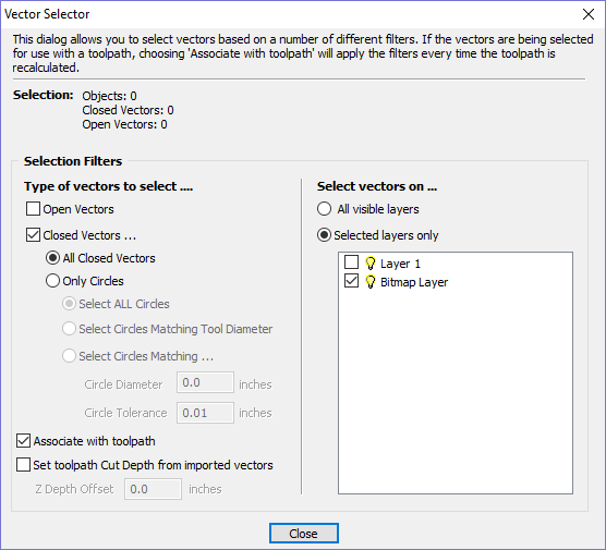

Vector Selection Mode
When the Vector Selection Tool is chosen, the selected vectors are shown as dotted magenta lines. Vectors need to be selected before any of the editing tools such as scaling and moving etc. can be used.
Vector selection methods
Multiple vectors can be selected in the following ways:
  1. Manual multiple selection:
    Hold down the Shift key while clicking the Left mouse button on each vector required. Objects can be deselected by simply clicking on the object again with a Shift key pressed.
  2. Moving the cursor from Left to Right selects only fully enclosed objects:
    Click and drag the left mouse button moving from Left to Right selects all objects completely inside the selection rectangle.
  3. Moving the cursor from Right to Left selects all objects inside or touching the selection rectangle:
    Click and drag the left mouse button moving from Right to Left selects all objects inside the selection rectangle + any that the selection touches.
  4. Pressing the keyboard keys Ctrl+A will select all vector objects in the design:
    Selected vectors are displayed as dotted magenta lines.
Deselecting Vectors
Selections can be cancelled by:
  • Left clicking on an area outside the selection
  • Pressing the Esc key
  • Pressing the Right mouse button and clicking Selection ► Unselect All from the pop-up menu.
    You must click on the white drawing background to get this option in the pop-up menu.
Migration Dialog
This tool helps existing users migrate their data from an older installation into the new version. You can migrate things like the Tool Database, Post-Processors in My_PostP, Options and various Defaults.
  • Copy Machine / Tool Database; This will migrate your tool database and machines and the post-processor associations. You can check the data from the Tool Database and Machine Configuration dialogs.
  • Backup Tool Database Online; This will back up the new tool database (just migrated) to your online tool database backup area for the new version.
  • My Post Processors; This will only copy your custom Post Processors in My_PostP folder.
  • Options; Copy most of the options on Options Dialog.
  • Custom Material Textures; For use in simulation and job setup.
  • Sculpting Presets; Only in Aspire for use in the Sculpting tool.
  • Use Legacy 3D View Control; This allows you to retain the ability to move the 3D View using the left mouse button as seen in V11.5 and older software, and not use the new V12 3D control options.
If the Legacy 3D view control is selected then some features in the 3D view will not be available. This can be changed later in the Program options by going to Edit -> Options.
